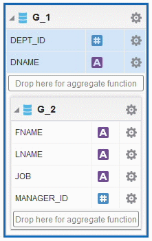

Group Break and Sort Data
The data model provides a feature to group breaks and sort data.
Sorting is supported for parent group break columns only. For example, if a dataset of employees is grouped by department and manager, you can sort the XML data by department. If you know how the data should be sorted in the final report or template, you specify sorting at data generation time to optimize document generation. The column order specified in the SELECT clause must exactly match the element orders in the data structure. Otherwise group break and sort may not work. Due to complexity, multiple grouping with multiple sorts at different group levels isn't allowed.
Example: In the example shown below, sort and group break are applied to the parent group only, that is, G_1. Notice the column order in the query, dataset dialog, and data structure. The SQL column order must exactly match the data structure element field order; otherwise, it may result in data corruption.
Example:
SELECT  d.DEPARTMENT_ID DEPT_ID, d.DEPARTMENT_NAME  DNAME,
        E.FIRST_NAME FNAME,E.LAST_NAME LNAME,E.JOB_ID JOB,E.MANAGER_ID
FROM EMPLOYEES E,DEPARTMENTS D
     WHERE D.DEPARTMENT_ID = E.DEPARTMENT_ID
     ORDER BY  d.DEPARTMENT_ID, d.DEPARTMENT_NAME
Once you define the query, you can use the data model designer to select data elements and create group breaks as shown below.
The Data Structure with breaks is:
