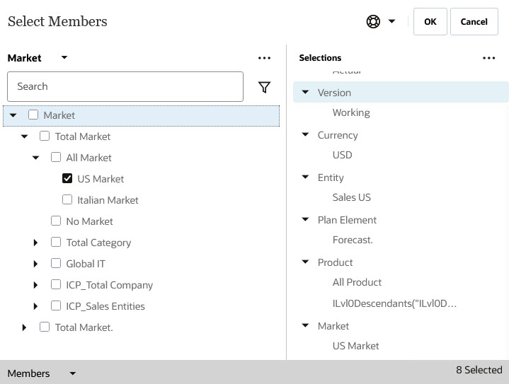

  2. In the Define Model Scope section, for the remaining dimensions, select the members that define the location of the historical data that should be used to train the advanced prediction model.
    To select the members, click a dimension, and then use the member selector to select the members. You can also use functions to select members.
    Define model scope example
    Member selector to define the model scope
