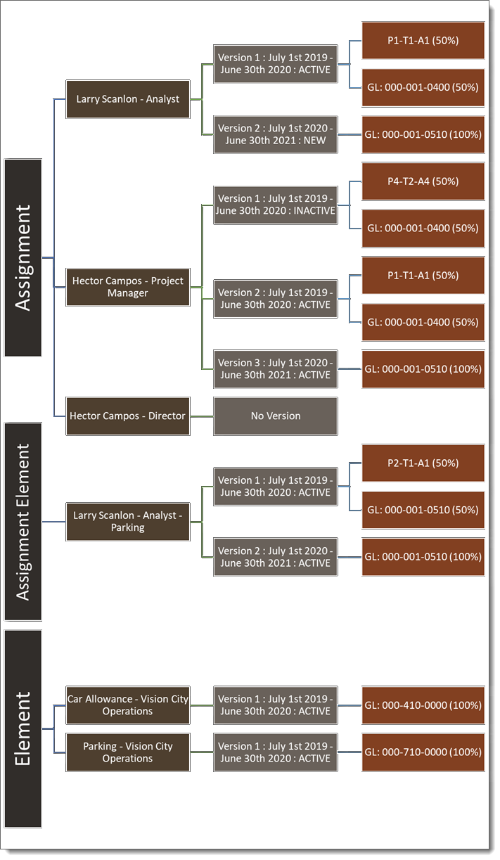

Labor Schedule Components, Types, and Distribution: Example
Here's an example that illustrates how you can use labor schedule components to create labor schedules, how you can create labor schedules of various types, and how these will be distributed when run.
Larry Scanlon, an analyst in Vision City Operations, has the following personalized labor schedules:
Labor Schedule Type Labor Schedule Header Labor Schedule Version Distribution Rules
Assignment Larry Scanlon - Analyst Version 1: July 1st 2019 - June 30th 2020, ACTIVE P1-T1-A1 (50%)
GL: 000-001-0400 (50%)
Version 2 : July 1st 2020 - June 30th 2021 : NEW GL: 000-001-0510 (100%)
Assignment Element Larry Scanlon - Analyst - Parking Version 1 : July 1st 2019 - June 30th 2020 : ACTIVE P2-T1-A1 (50%)
GL: 000-001-0510 (50%)
Version 2 : July 1st 2020 - June 30th 2021 : ACTIVE GL: 000-001-0510 (100%)
Hector Campos, a director in Vision City Operations, has the following personalized labor schedules:
Assignment Hector Campos - Project Manager Version 1 : July 1st 2019 - June 30th 2020 : INACTIVE P4-T2-A4 (50%)
Version 2 : July 1st 2019 - June 30th 2020 : ACTIVE P1-T1-A1 (50%)
Version 3 : July 1st 2020 - June 30th 2021 : ACTIVE GL: 000-001-0510 (100%)
Hector Campos - Director No Version
Additionally, Vision City Operations offers two pay element components to all their employees' salaries, administered through the following labor schedule:
Element Car Allowance - Vision City Operations Version 1 : July 1st 2019 - June 30th 2020 : ACTIVE GL: 000-410-0000 (100%)
Parking - Vision City Operations Version 1 : July 1st 2019 - June 30th 2020 : ACTIVE GL: 000-710-0000 (100%)
Putting them together, we have the following labor schedules for these two employees:
Graphic depicting the labor schedules created for Larry Scanlon and Hector Campos
Here's a table that describes the distribution of payroll based on the labor schedules illustrated above. The Import Payroll Costs process evaluates the cost records matching the attribute combination to labor schedule Versions and distribution rules that apply.
