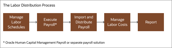

The Labor Distribution Process
Here's a graphic that offers a high-level view of the Labor Distribution process.
As illustrated in the graphic above, Labor distribution comprises the following five high-level tasks:
- Manage Labor Schedules: Create labor schedules to specify project and nonproject based rules that must be used when distributing a person's payroll costs. See Labor Schedules for more information.
- Execute Payroll: Execute payroll to determine the actual wages that must be paid to employees and contractors.
- Import and Distribute Payroll: Run the Import Payroll Costs process. This process imports payroll costs, validates them, and uses the configured labor schedules to process the transactions and create project cost distributions.
- Manage Labor Costs: Review and resolve exceptions to these distributions using the Manage Labor Costs page, ensuring that all payroll costs get distributed as expected.
- Report: View and report on labor schedules and costs using Oracle Transactional Business Intelligence (OTBI).
