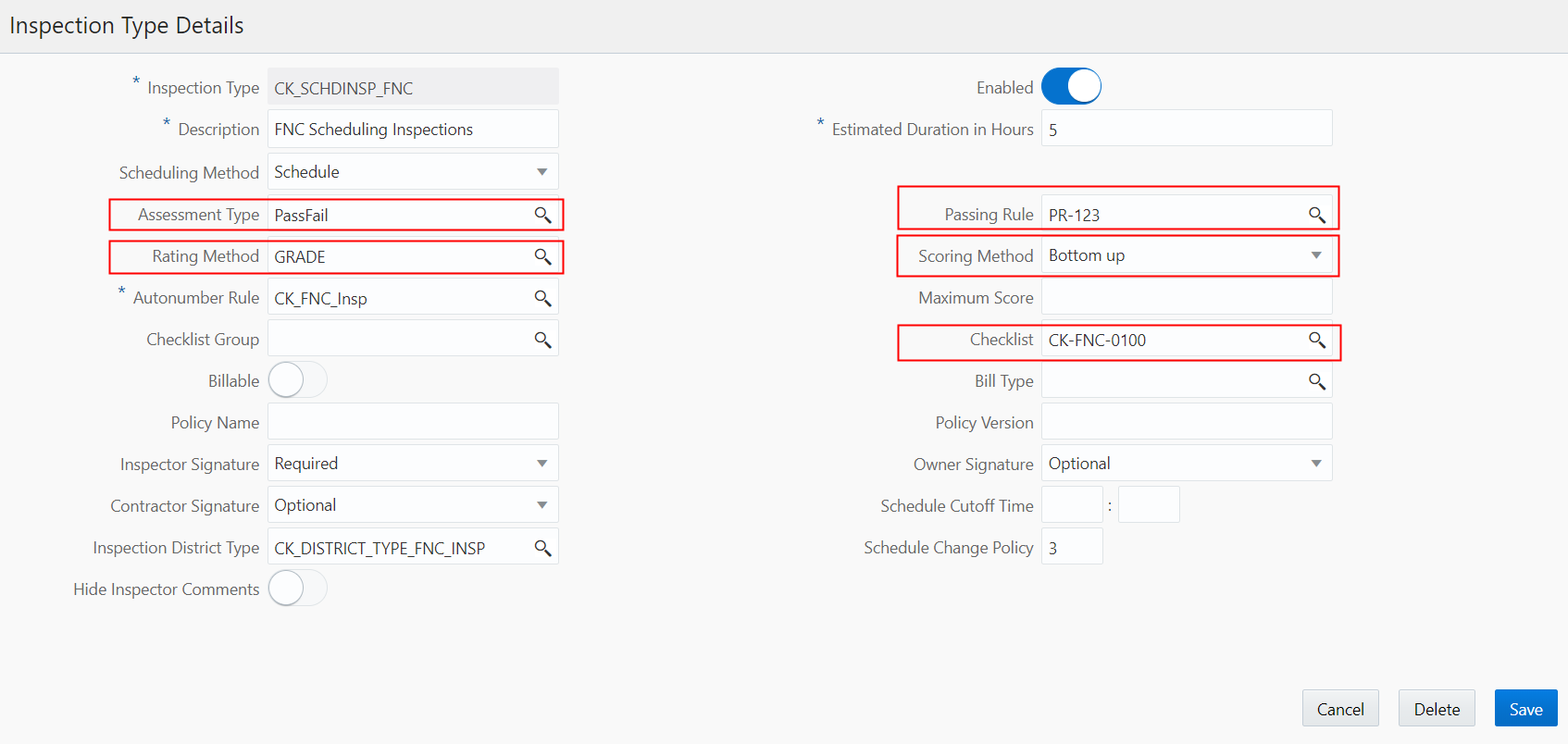

Example: Using the Bottom Up Scoring Method
Before you begin, set up the assessment type, rating method, passing rule, scoring method, and checklist, which includes the checklist items. In this case, you don’t need to set up the checklist group, because checklist and checklist group are mutually exclusive of each other.
This example illustrates setup for an inspection on the Inspection Type Details page. Details are in the surrounding text.
Example of an inspection type set up with Bottom Up scoring
The setup includes the following:
  1. Assessment Method
    The assessment method is defined on the assessment type page and used in the inspection type definition. During the inspection, the inspector selects an available assessment which is associated with a system result. The system result determines the scoring calculation as follows:
    Displayed Assessment
    System Result
    Scoring Calculation
    Pass
    Pass
    Score = All Points
    Corrected on Site
    Corrected
    Score = All Points
    Fail
    Fail
    Score = No Points
    NA (not applicable)
    Other
    Score = No Points
    Note: Only the displayed assessment value is configurable by the agency. The available system results are Pass, Fail, Corrected, and Other. You must have one assessment with a system result of Pass and one assessment with a system result of Fail. You can define multiple assessments with system results of Corrected and Other.
    See Setting Up Inspection Assessment Types.
  2. Inspection Scoring Method
    The scoring method is defined on the inspection type. In this example, the scoring method is Bottom Up.
    See Setting Up Inspection Types.
  3. Rating Method
    When you use a scoring method, you also must set up a rating method. The rating method defines the range of scores used at the inspection type level.
    See Setting Up Rating Methods.

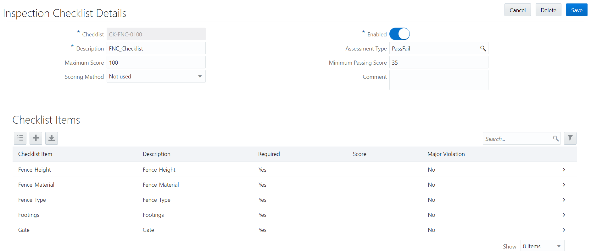

  4. Checklist
    The checklist used in the inspection is defined on the inspection type. For example, the checklist could be Electrical for a residential addition. For multiple checklists, you enter a checklist group name. A checklist group can have different inspection checklists, such as both Electrical and Plumbing for a residential addition.
    See Setting Up Inspection Checklists.
  5. Checklist Item
    The inspection score is defined in the inspection checklist details. In this example, each checklist item is set up with a possible score of 25. The inspector’s assessment determines how many points are applied to the checklist. When the inspection result is Pass, the item receives the complete score.
    See checklist details in Setting Up Inspection Checklists.

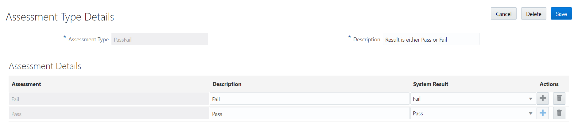

Assessment types identify the results available for assessing an inspection, for example, Pass and Fail. You add, modify, or delete assessment types and codes for inspections on the Assessment Type pages.
An assessment type includes one or more assessment codes, which identify the possible results for the inspection type. Assessment types are also used for inspection checklist and checklist item results.
Assessment types function independently of the scoring method, maximum score, and minimum score, for example:
  • If the system result is Pass or Corrected, the full score is assigned.
  • If the system result is Other or Fail, the score is 0.
Scoring for each system result is predefined in the system for inspections.
This example illustrates the Assessment Type Details page containing the field values described in the following table.

This example illustrates the Inspection Checklist Details page containing the field values described in the preceding table.
Adding Inspection Checklists
  1. Select Inspection Setup > Inspection Checklist.
  2. On the Inspection Checklist page, click Add to add a checklist.
  3. On the Inspection Checklist Details page, enter a checklist ID and description.
  4. Verify that the Enabled switch is turned on. The switch is turned on by default for new checklists.
  5. You can also enter values for these fields:
    Page Element
    Description
    Assessment Type
    Enter an assessment type.
    The system determines a passing result based on the assessment type defined for the checklist. The assessment that is defined with system status Pass is used for the passing result. Otherwise, the assessment that is defined with the system status Fail is used.
    Assessment types function independently of the scoring method, maximum score, and minimum score.
    Maximum Score
    Enter the maximum score possible for the checklist. This value is required if the scoring method is Top down, which will be available in a future release.
    Minimum Passing Score
    Enter a minimum score for a passing grade. This value is required for the scoring method Bottom up.
    If the total score for the checklist is equal to or greater than the minimum passing score, the checklist receives a passing result.
    Scoring Method
    Select a scoring method to be used for the checklist:
    • Bottom up: Scoring from the bottom up indicates that the scoring starts with zero and the inspector adds points for the criteria that are met.
    • Not used: This is the default value and indicates that no scoring method is used for this checklist. You must specify the result manually for each level: checklist item, checklist, and inspection.
      If you don’t use the scoring method you can’t use the passing rule and rating method. This also means that results are not automatically calculated starting with the checklist items to the checklist to the inspection level.
    Note: The scoring method specified for the checklist should match the scoring method in the Inspection Type definition.
    Comment
    Enter any additional information.
  6. Click Save.
Adding Inspection Checklist Items
  2. On the Inspection Checklist page, select the row for the checklist to which you want to add checklist items.
  3. On the Inspection Checklist Details page, click the Add button in the Checklist Items section to add the first checklist item. Click the Add icon for additional checklists.
  4. Enter values for fields on the Checklist Item Details page. Required fields include the checklist item ID and description.
    Page Element
    Description
    Checklist Item and Description
    Enter an ID and description for the checklist item.
    Score
    Enter the score the item receives if it passes the inspection.
    Major Violation
    Turn on the switch to indicate that this checklist item is considered a major violation if it does not pass inspection.
    Category and Subcategory
    Enter a category and subcategory for the checklist item. See Setting Up Inspection Checklist Categories.
    Instructions
    Click the Add button in the Instructions section to add instructions for inspecting the checklist item.
    Add instructions on the Instruction Details page, including an instructions ID and the instructional text.
  5. The Required switch is turned on by default to indicate that the inspection of the item is required. The inspector can’t submit the inspection result until all required checklist item and checklist results are complete.
    If the checklist item is not required, you can turn off the switch.
  6. Click Save.

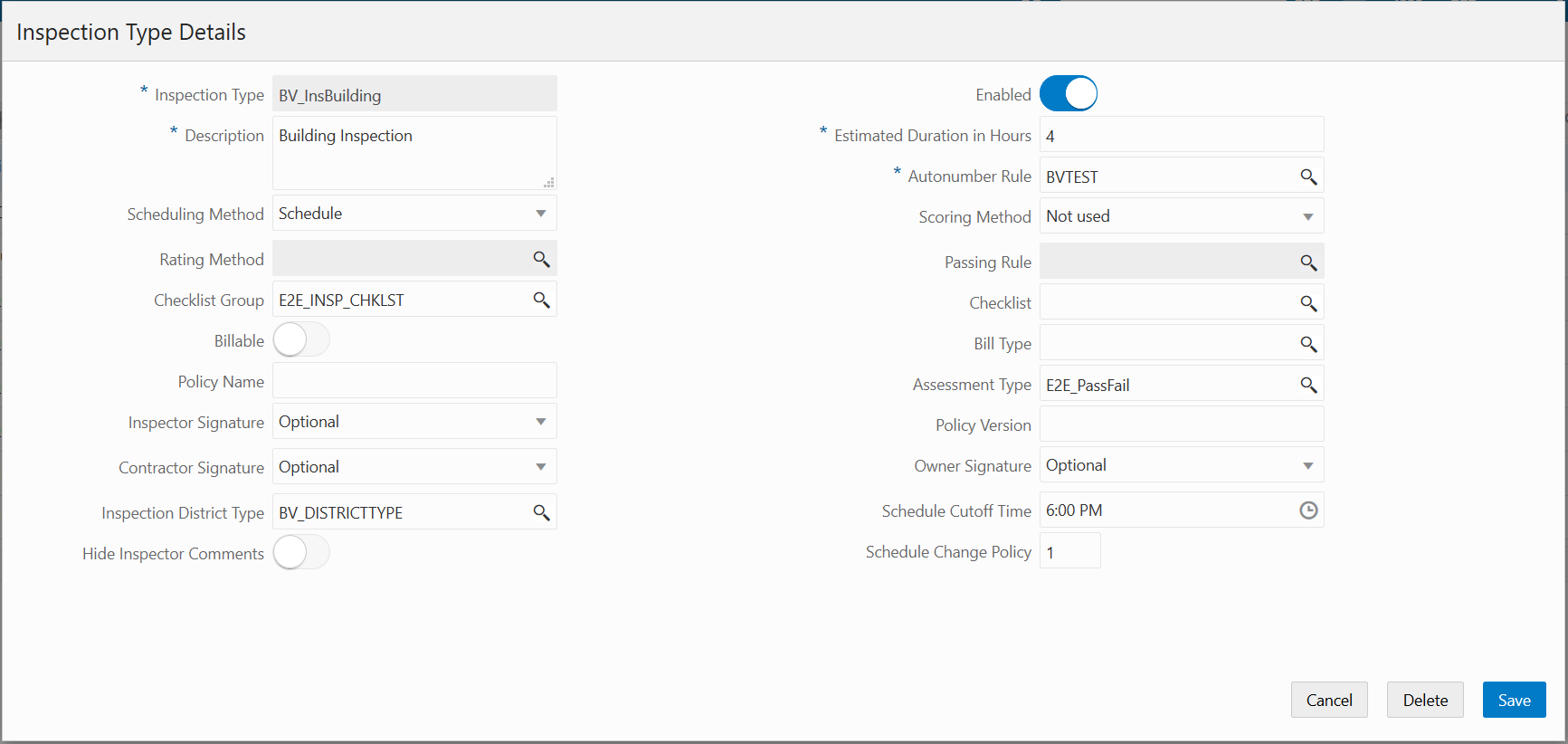

Define inspection types used by your agency to identify the requirements and options for different types of inspections. You set up information such as scheduling, assessments, checklists, billing, signatures required, and comments on the Inspection Type pages.
The inspection type is associated with the permit for the scheduled inspection and defines the different attributes for performing the inspection.
This example illustrates the Inspection Type Details page containing the field values described in the following table.
Note: When you modify an inspection type, the updated values are applied to new inspections using the inspection type. Existing inspections use the original inspection type definition. This does not apply to the Schedule Cutoff Time and Schedule Change Policy fields, which are referenced when the inspection is scheduled and not stored on the inspection itself.
Adding Inspection Types
You add inspection types for your agency on the Inspection Type page. You must set up the attributes for the inspection type before you begin.
  1. Select Inspection Setup > Inspection Type.
  2. On the Inspection Type page, click Add New to add a new inspection type.
  3. Enter values for fields on the Inspection Type Details page. Required fields include Inspection Type and Description, Estimated Duration in Hours, and Autonumber Rule.
    Page Element
    Description
    Enter a unique ID and description for the inspection type.
    Enter the estimated number of hours this type of inspection will take.
    This field is required for scheduling. For more information, see Setting Up Inspection Scheduling.
    Scheduling Method
    Select the scheduling method for inspections associated with this inspection type.
    Select Ready to enable applicants to indicate the date and time when the site is ready to be inspected. Inspections with this scheduling method are assigned and scheduled by inspection supervisors using the supervisor calendar.
    Select Schedule to enable applicants to select a date and time when requesting inspections.
    Select Request to enable applicants to select a preferred date and time range for requested inspections. Inspections with this scheduling method are assigned and scheduled by inspection supervisors using the supervisor calendar.
    For more information on inspection scheduling, see Setting Up Inspection Scheduling and Assigning Inspections Using the Supervisor Calendar.
    Assessment Type
    Enter an assessment type, which is used in the inspection result processing.
    For more information, see Setting Up Inspection Assessment Types.
    Passing Rule
    Enter a passing rule, which defines the criteria for determining whether an inspection passes or fails.
    For more information, see Setting Up Passing Rules.
    Rating Method
    Enter a rating method, which defines the scoring ranges used by the passing rule to determine whether an inspection passes or fails.
    You must set up a rating method if you are using scoring. For more information, see Setting Up Rating Methods.
    Scoring Method
    Select a scoring method from these options:
    • Bottom up: Scoring bottom to top indicates that the inspector starts with zero and adds points for each criterion that is met. You must set up a passing rule for bottom up scoring.
    • Not used: This is the default value and indicates that no scoring method is used for this inspection. You must specify the result manually for each level: checklist item, checklist, and inspection.
    Autonumber Rule
    Enter the ID for the automatic numbering rule to use for generating the inspection transaction key.
    For more information, see Setting Up Autonumbering.
    Checklist Group
    You can enter a checklist group. If you enter a checklist group, you cannot also enter a checklist ID.
    For more information, see Setting Up Inspection Checklist Groups.
    Checklist
    You can enter the ID for a single checklist. You cannot enter both a checklist group and a checklist ID.
    For more information, see Setting Up Inspection Checklists.
    Billable
    Click this slider if this inspection type is billable. When you turn on this switch, the Bill Type field becomes required.
    Bill Type
    Enter a bill type. This field is required if the Billable switch is turned on.
    For more information, see Setting Up Bill Types.
    Policy Name and Policy Version
    Enter the name of the template and version number the Oracle Intelligent Advisor policy.
    For more information, see Overview of Oracle Intelligent Advisor Configuration.
    Inspector Signature
    Owner Signature
    Contractor Signature
    Select a signature option for the inspector, owner, and contractor associated with the inspection type:
    • Required: The signature field appears on the Inspection Results page.
      Note: Inspectors can’t submit a completed inspection if required signatures are missing.
    • Not Required: The signature field does not appear on the Inspection Results page.
    • Optional: A signature is optional for this inspection type.
    The default value for the Inspector Signature is Required.
    The default value for the Owner Signature and Contractor Signature is Optional.
    Enter the time after which applicants and non-supervisor agency staff can no longer schedule inspections for the current day or the next day using the Scheduling modal page. For example, if the cut off is 3:00 PM and the current time is 4:30 PM, the inspection can’t be scheduled for today or tomorrow. The inspection must be scheduled for the day after tomorrow.
    Note: This field does not affect an inspection supervisor’s ability to override inspection assignment times through the Scheduling modal page. It also does not affect automatic batch assignment.
    Inspection District Type
    Enter the inspection district type for this inspection, for example a building, electrical, or plumbing inspection district. When the inspection with this inspection type is scheduled, the system finds the inspector who is assigned to a district belonging to the inspection district type defined on the inspection type.
    Enter the acceptable number of hours prior to the inspection that the user can change the schedule or cancel an inspection.
    Hide Inspector Comments
    Turn on this switch if you want to hide inspector comments from public users. The default value for this switch is off so that inspector comments are visible.
  4. Verify that the Enabled switch is turned on if you want to enable this inspection type when you save it. The switch is turned on by default for a new inspection type.
  5. Click Save.
