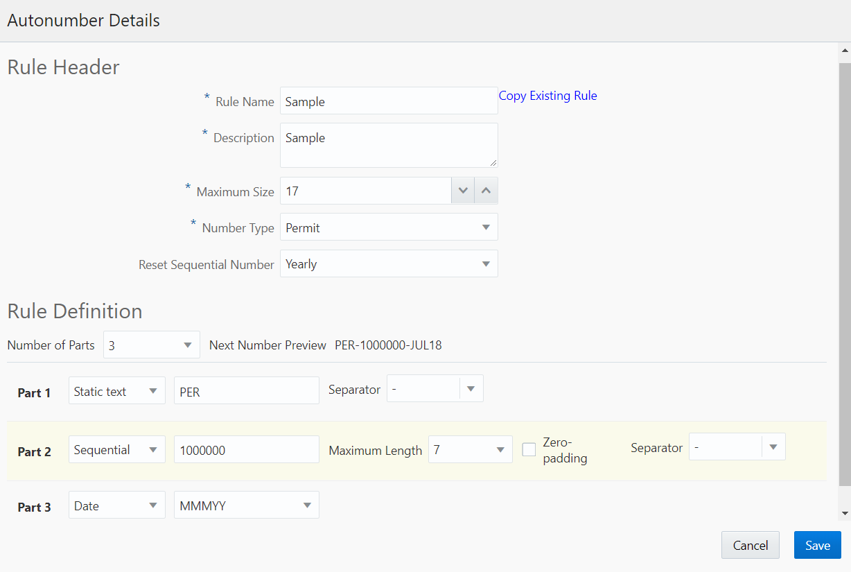

This example illustrates the Autonumber Details page.
Adding an Autonumber Rule
  1. Select Common Setup > Autonumber.
  2. On the Autonumber page, click Add.
  3. On the Autonumber Details page, enter values for the fields in the Rule Header section:
    Page Element
    Description
    Rule Name
    Enter a unique name for the rule. The name can’t include spaces.
    Copy Existing Rule
    Click this link to copy the rule definition from an existing autonumber rule. The copy action copies the number type and the reset frequency as well as the actual rule definition.
    Clicking the link opens a a modal window with a list of existing autonumber definitions. Locate the definition you want to copy, then click the Select button for that definition
    Description
    Enter a description for the autonumber rule.
    Maximum Size
    Indicate the maximum length of the generated number.
    Note: As you set up your autonumber rule, take care that the maximum size of the autonumber accommodates the maximum length of each part of the identifier plus any separators that you define.
    Number Type
    Select the type of object that uses this autonumber rule:
    • Case
    • Cashier session
      Note: If you select this number type, make sure that the rule uses only Sequential part types.
    • Code inspection
    • Deposit slip
    • Incident
    • Inspection
    • Invoice
    • Permit
    • Planning application
    • Project
    • Receipt
    These values are defined on the Lookup Type Details page for the ORA_PSC_CC_AUTONUM_TYPE lookup type.
    Reset Sequential Number
    The identifier that an autonumber rule generates can include a mix of static text, a date, and a sequential number. Select how often the sequential number portion of the identifier is reset to zero:
    • None: Sequential numbers continue to increment as defined without resetting.

  4. In the Rule Definition section of the page, enter the number of parts, or segments, for the rule:
    Page Element
    Description
    Number of Parts
    Select the number of parts, or segments, comprising the rule, up to 5 parts. Segments can be static text, a date, or a sequential number.
    For example, the identifier IVC-0000010067-OCT10 is made of 3 segments (static text, then a sequential number, then a date) separated by hyphens. The identifier INVOICE_001 is made of 2 segments (static text and a sequential number) separated by an underscore.
    When you select the number of parts, the corresponding number of rows appear in the rule definition grid. For example, if there are two parts, then rows labeled Part 1 and Part 2 appear.
  5. In the rule definition grid, select the part type for each row, then enter the related information in the additional fields that appear.
    Part Type
    Related Information
    Static Text
    In the unlabeled field that appears next to the part type, enter text that remains the same for all identifiers. For example, enter IVC or INVOICE.
    Note: Do not include spaces in the static text.
    Cashier session IDs must be numeric, so don't include any static text in an autonumber definition with the Cashier Session number type.
    Sequential
    1. In the unlabeled field that appears next to the part type, enter the next document number to use. The number must be 1 or greater. The system increases this number by one each time a new identifier is generated and saved.
    2. In the Maximum Length field, Enter the maximum number of digits for the sequential number. Select a number from one to ten.
    3. Select the Zero Padding check box to add zeros before the generated number to make up the number of digits in the definition. For example, if the maximum length of this part is 5 digits, and the current number is 15, zero padding formats this part as 00015.
    Date
    In the unlabeled field that appears next to the part type, select the date format.
    The available date formats are made of these date codes in various combination:
    • Years: YYYY represents the year with its full four digits, and YY represents the year by its last two digits.
    • Months: MM represents the month as a two-digit number, and MMM represents the month as a three-character abbreviation such as JAN for January.
    • Days: DD represents days as two-digit numbers. This is the only option for days.
    • Quarters: Q represents quarters. For example, the code for the first quarter of the year is 1.
    Cashier session IDs must be numeric, so don't include any dates in an autonumber definition with the Cashier Session number type.
  6. In the rule grid, select a Separator to appear after each part except the last.
    Select from the following separators:
    • (None)
    • - (hyphen)
    • / (forward slash)
    • * (asterisk)
  7. Verify the generated number for the selected date format and separators in the Next Number Preview field.
  8. Click Save.

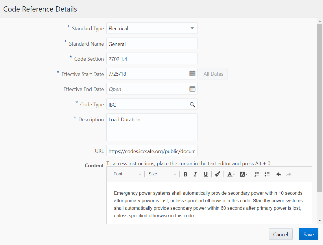

This example illustrates the Code Reference Details page.

Adding a Code Reference
  1. Select Common Setup > Code Reference.
  2. On the Code Reference page, click Add.
  3. On the Code Reference Detail page, enter values for the following fields:
    Page Element
    Description
    Standard Type
    Select the type of standard that the code falls under. Standard types represents fields or disciplines such as Materials, Engineering, or Installation.
    Standard Name
    Enter the title of the section that contains this code reference. This title comes from the source document.
    Code Section
    Enter the section number for this code reference. The number uniquely identifies this reference within the source document.
    Effective Start Date and Effective End Date
    Enter the official effective start date of the code reference, and optionally enter an end date.
    Code Type
    Select a code type from the values that you defined on the Code Type page. The code type identifies the source document.
    See Setting Up Code Types
    Description
    Enter a description of the reference.
    URL
    Enter a URL link to the source document.
    Content
    Enter detailed content copied from the source document.
  4. Click Save.

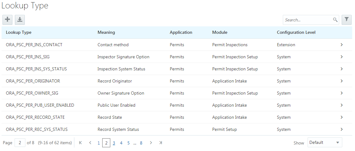

Lookup Type page
To modify a lookup type:
  1. Select Common Setup > Lookups.
  2. On the Lookup Types page use the Search box to filter the lookup types by keyword.
    For example, to view the Business Type lookup type, enter business in the Search box.
  3. Click on the row for the lookup type you want to view.
  4. View the contents of the Lookup Type Details page.

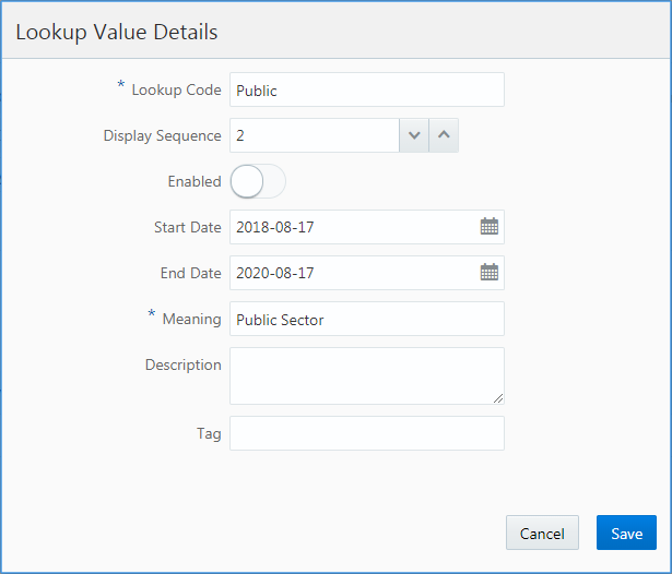

Lookup Value Details page
You can add lookup values to lookup types with a configuration level set to User or Extension.
To add lookup values:
  4. On the Lookup Type Details page, click Add under Lookup Value Type.
  5. On the Lookup Value Details page, enter these values:
    Page Element
    Description
    Lookup Code
    An internal application code for each lookup value that is not visible to users. It is typically a shorter, less user-friendly representation of the item. For example, ORA_DRIVER_LIC for State Driver’s License, or LEN for Length, if listing units of measurement.
    Display Sequence
    Control in what sequence the lookup value appears in the list displayed to users, where 2 appears above 3. If you do not specify a sequence, the application displays the items in the order they were entered.
    Enabled
    Turn on to make a lookup value active. If a lookup value is not enabled, then the application does not display it to the end user in the list of values for that lookup type.
    Start Date
    Set a start date for the lookup value to become active. Even if the lookup value is enabled, if a start date is set, the application does not display the lookup value until the start date is reached.
    End Date
    Set an end date for a lookup value to no longer be displayed in a list of values.
    Meaning
    The display name for the lookup value. End users see this value in the list of values displayed at run time. They do not see the Lookup Code value.
    Description
    Provide any additional information to help identify the purpose of the lookup value or clarification regarding what it represents.
    Tag
    Tags allow you to add a label to your lookup codes. A tag can be used to categorize lookups based on facilitating searches or guiding how a lookup should be used.
  6. Click Save.

  • User: Customers can add lookup values, delete lookup values, update the meaning, and update the description.
Task
User
Extension
System
Add a lookup type
Yes
No
No
Delete a lookup type
Yes
No
No
Modify lookup type meaning
Yes
No
No
Modify lookup type description
Yes
No
No
Add lookup values
Yes
Yes
No
Delete lookup values
Yes (if you created it)
No
Modify lookup value attributes
Yes (except for Lookup Code)
Yes (if you created it, and except for Lookup Code)
No
Adding Lookup Types
To add a lookup type:
  2. On the Lookup Types page click Add for the Lookup Type grid.
  3. On the Lookup Type Details page, enter these values:
    • Lookup Type (The value you enter must be uppercase and cannot begin with the prefix ORA_, which is used to distinguish your custom lookup types from delivered lookup types.)
    • Meaning
    • Module
    • Description
  4. Click Add for the Lookup Value grid for each lookup value you need to add to the lookup type.
  5. Click Save.
