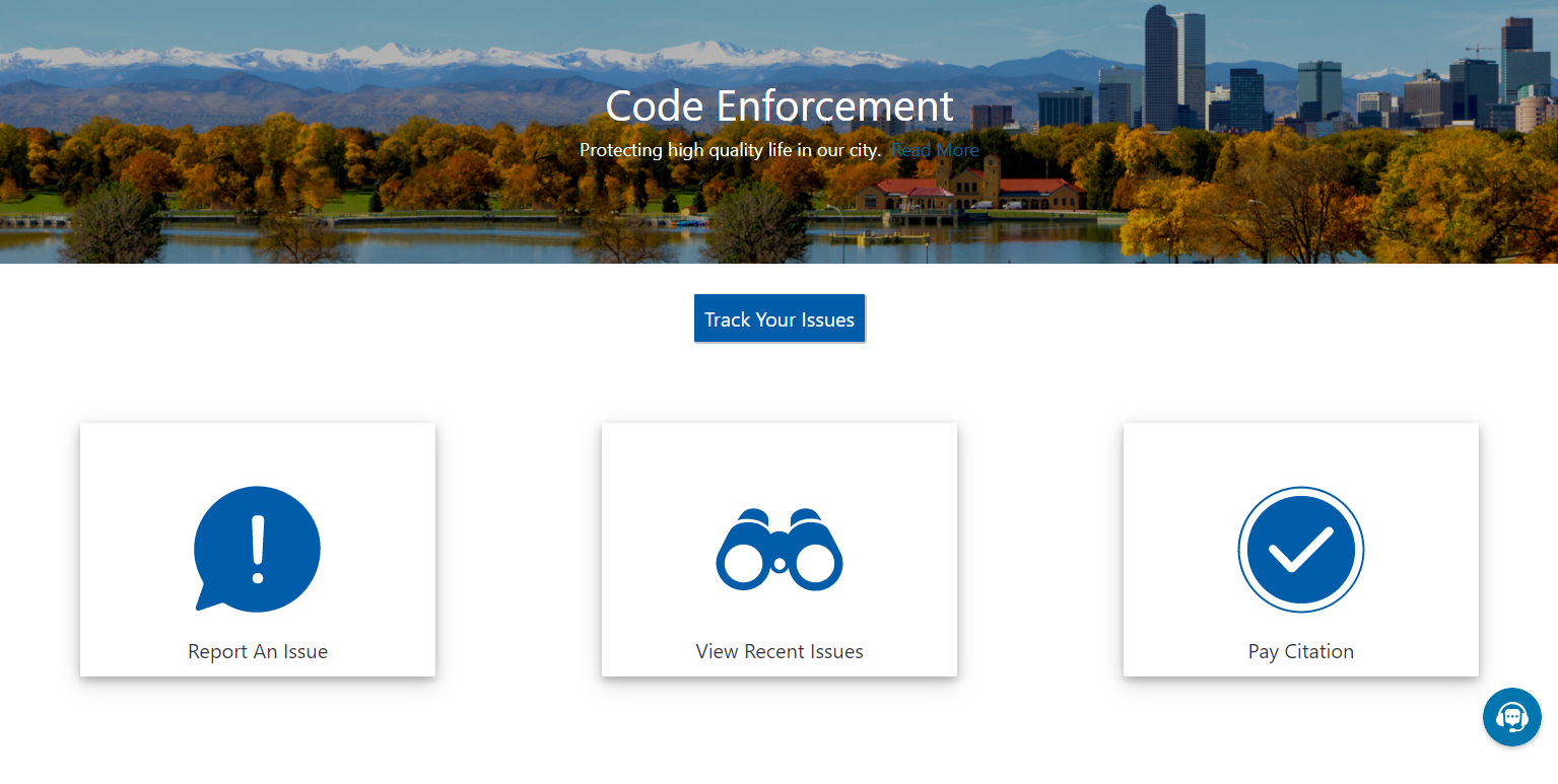

The public user landing page for code enforcement is the entry point for public users who want to report an issue, track issues that they reported, see recent issues in the agency’s jurisdiction, or pay a citation.
This example illustrates the public user landing page for code enforcement. In this example, a registered public user has signed in.
Public user landing page for code enforcement
The banner at the top of the page includes a title and a short message. After the message, a Read More link gives public users access to additional information that you set up.
For information on configuring these elements of the welcome banner, see Setting Up Agency-Level Options for Code Enforcement.
On the landing page, public users have access to these actions:
Tile or Button
Who Can Use
Description
Report an Issue
Registered users.
Anonymous users can see this tile, but they are prompted to sign in during the issue reporting process.
Report an issue to the agency. During the reporting process, the public user identifies the type of issue, provides the issue location, describes the issue, and answers any additional questions that the agency has configured.
See Reporting Issues.
