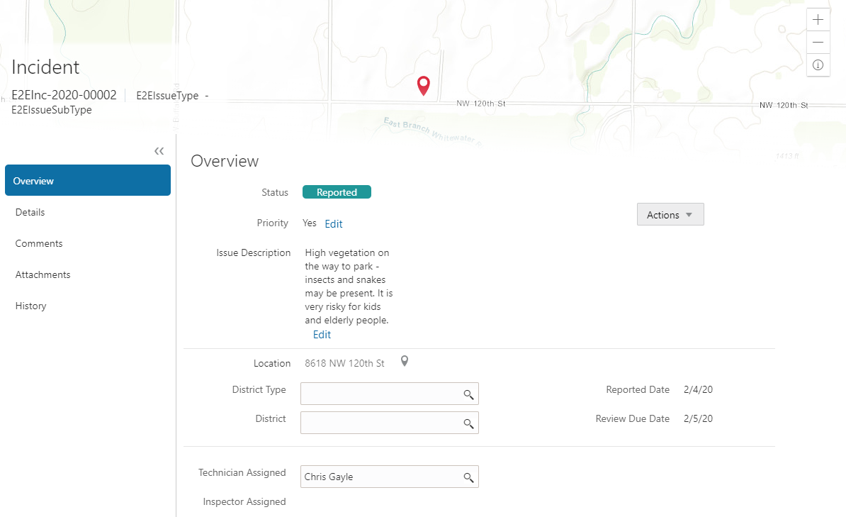

Working With Incident Details
The Incident page includes sections for the incident overview, details, comments, attachments, and history. The page also displays a map with the incident location. Use this page to view and update incident information, to claim or assign the incident, and to perform the actions for processing the incident.
This example illustrates the Incident detail page. The left frame provides links to tabs with various types of information.
Incident Details page

Using the Incident Overview Tab
The Overview tab on the Incident page displays summary information, enables you to update assignments, and provides access to the same actions that you can perform from the Worklist page.
To use the Overview tab:
  1. Access the incident.
    The Incident page appears and displays the Overview tab by default. If you navigate away from this tab, return by clicking Overview in the left frame.
  2. Review the incident Status and, if the incident is closed, review the closure Reason.
    The following table describes incidents statuses and reasons:

  4. Review the following general incident information:
    Page Element
    Description
    Priority
    Displays Yes or No to indicate whether the incident is a priority issue.
    The initial value corresponds to the how the person who reported the incident answered the question Does this issue pose a health hazard or public safety risk.
    If the incident is in Reported status, the assigned technician can click the adjacent Edit link to change the incident priority.
    Issue Description
    Displays a description of the problem that was reported.
    If the incident is in Reported status, the assigned technician can click the adjacent Edit link to open the Edit Description window and change the description. Even if the technician edits the description, the original issue description still appears on the Details tab.
    Location
    Displays the location of the incident. This can include an address and any additional location information that was provided.
    If the incident is in Reported status, the assigned technician can click the map marker icon next to the current location to open the Update Location window and select a new location.
    The technician can type the new location into the address search box or drag the map so that the location crosshairs are over the new location. When the technician closes the window, the new address replaces the old one on this page. The original address still appears on the Details tab.
    Reported Date
    Displays the date that the incident was originally submitted.
    Review Due Date
    Displays the due date for code technician to process the incident. Claiming an incident is not sufficient: the technician must close the incident or schedule an inspection. (The inspection does not have to be performed by the review due date—it has its own due date.)
    The review due date is calculated based on the issue subtype, the date the incident was reported, and the incident priority.
  5. Review information about the incident district, and update the information if necessary.
    Page Element
    Description
    District Type ID
    Identifies the code enforcement district type for the incident. For example, incidents might be associated with a fire prevention district type.
    The district type is inherited from the issue subtype and is read-only. However, if the field is blank because the issue subtype doesn’t have a district type, you can manually select one. The field becomes read-only after you enter a value.
    District
    Confirm or update the specific district where the incident is located. This district is based on the district type and the issue location:
    • With GIS integration, the system finds the district using the GIS map layer that is associated with the district type..
    • If the agency doesn’t use GIS integration, the system looks for the code enforcement district that is associated with the parcel.
    • If the system is unable to determine the district, you can manually enter one.
    The district determines the default code officers for the incident. For example, if an incident is in fire prevention district 2, then the code officers who are assigned to that district are listed when you schedule an inspection.
    Code officers are assigned to specific districts using the Code Enforcement Districts attribute of the Code Enforcement Officer job function.
    For more information about setting job function attributes, see Setting Up Agency Staff.
  6. Review and, if necessary, update the incident assignments using these fields:
    Page Element
    Description
    Technician Assigned
    Identify the code enforcement technician who is responsible for the initial review and processing for the incident.
    You can update this field directly, or use the Reassign action in the Actions menu.
    Inspector Assigned
    Identify the code enforcement officer who is responsible for an initial inspection. An inspector is assigned when the inspection is scheduled.
    This field is editable only if the incident is in Inspection status. When you change the assignment, the system does not check the new assignee’s workload. After you assign the new inspector, the assignment is also updated on the corresponding inspection record.
  7. If an inspection has been scheduled, review the Inspection ID and Inspection Status fields.
    These fields display information about the initial inspection for the incident.
