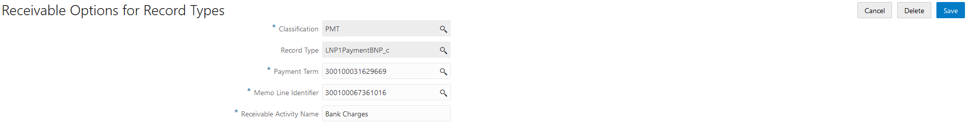

Adding Receivable Options for a Record Type
  1. On the Receivable Options for Record Types page, click Add.
    This example shows the Receivable Options for Record Types details page.
    Example of the Receivable Options for Record Types details page
  2. Enter values for the following fields:
    Page Element
    Description
    Classification
    Select the offering that the record type receivable options apply to. Values may include:
    • LIC (Business Licenses)
    • PMT (Permits)
    • PZ (Planning and Zoning)
    • CE (Code Enforcement)
    Record Type
    Select the specific record type to which these receivable options apply.
    Payment Term and Memo Line Identifier
    Enter an invoicing payment term and memo line identifier.
    Note: These fields are required even though invoicing integration is not currently available.
    Receivable Activity Name
    Enter the receivable activity name that PSCR assigns to payments with the selected record type when sending information to Oracle Receivables. Make sure that this value matches the value defined in Oracle Receivables exactly.
  3. Click Save.

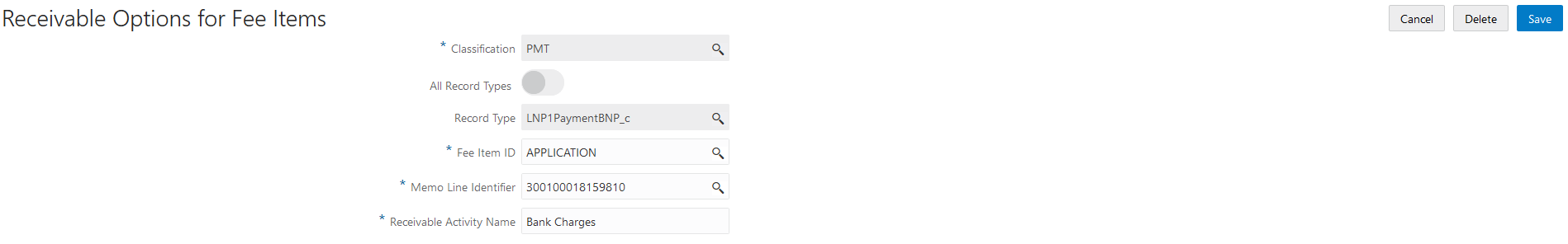

Adding Receivable Options for a Fee Item
  1. On the Receivable Options for Fee Items page, click Add.
    This example shows the Receivable Options for Fee Items details page.
    Example of the Receivable Options for Fee Items details page
    Page Element
    Description
    Classification
    Select the offering that the fee item receivable options apply to. Values may include:
    • PMT (Permits)
    All Record Types
    Turn this switch on to apply the receivable options to this fee item for all record types.
    Record Type
    Select the specific record type to which these fee item receivable options apply. This field is unavailable if you turn on the All Records Types switch.
    Fee Item ID
    Select the fee item to which the receivable options apply.
    Enter an invoicing memo line identifier.
    Note: This field is required even though invoicing integration is not currently available.
    Enter the receivable activity name that PSCR assigns to payments with the selected fee item when sending information to Oracle Receivables. Make sure that this value matches the value defined in Oracle Receivables exactly.
  3. Click Save.
