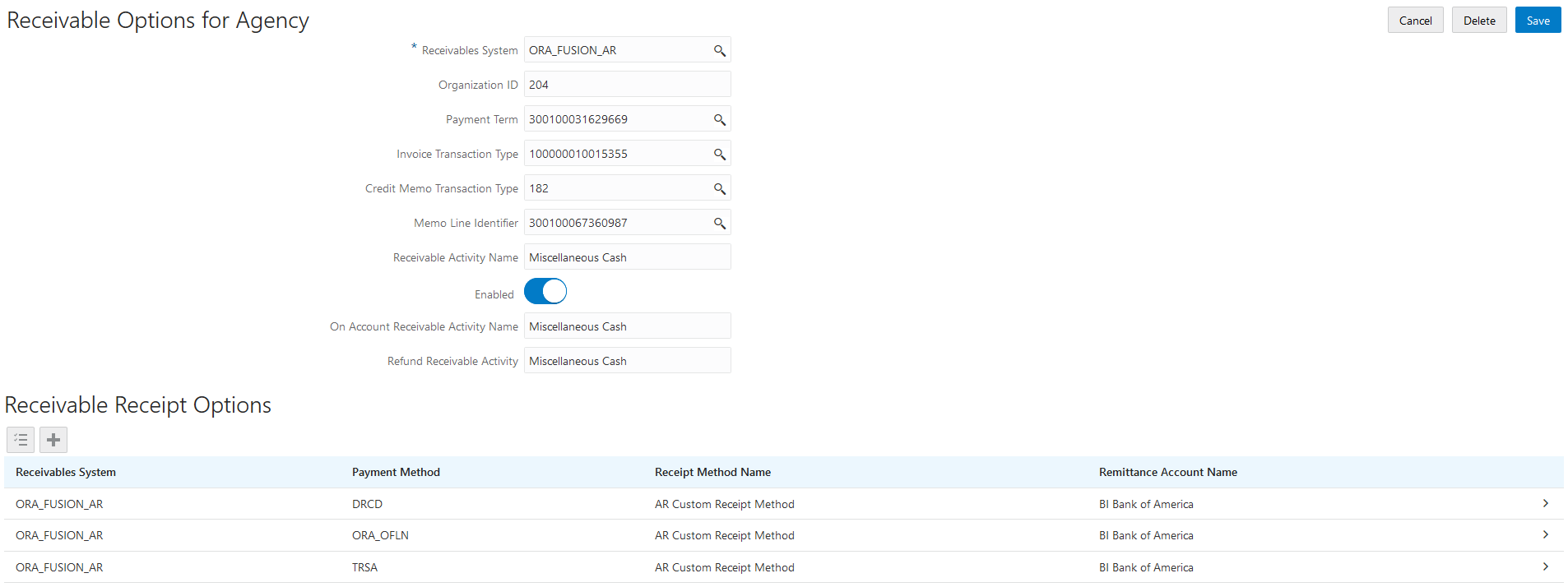

Setting Up Agency Receivable Options
Define how your agency integrates with Oracle Receivables using the Receivable Options for Agency page.
Define Agency Level Receivable Options
  1. Select Billing Setup > Agency Receivable Options.
  2. Select the row for your agency.
    This example shows the Receivable Options for Agency page.
    Example of the Receivable Options for Agency details page
  3. Enter values for the following fields:
    Page Element
    Description
    Receivables System
    Select your Oracle Receivables system.
    Organization ID
    Enter the Oracle Receivables organization ID associated with your agency.
    Payment Term, Invoice Transaction Type, Credit Memo Transaction Type, Memo Line Identifier
    Enter your invoicing information.
    Note: These fields are required even though invoicing integration is not currently available.
    Enabled
    Turn on this switch to enable the integration between PSCR and Oracles Receivables. When this switch is off, PSCR processes all received payments using normal accounting.
    Receivable Activity Name
    Enter the default receivable activity name that PSCR assigns to payments that don’t match receivable options defined at the record type or fee item level. Make sure that this value matches the value defined in Oracle Receivables exactly.
    On Account Receivable Activity Name
    Enter the receivable activity name that PSCR assigns to overpayments. All overpayments for the agency are assigned the same receivable activity name and do not have receivable options set at the record type or fee item level.
    Refund Receivable Activity
    Enter the receivable activity name that PSCR assigns to refunds. All refunds for the agency are assigned the same receivable activity name and do not have receivable options set at the record type or fee item level.
    Note: PSCR generates negative miscellaneous receipts for refunds.
  4. Add receivable receipt options for your payment methods.
  5. Click Save.

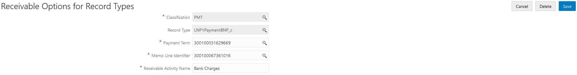

Setting Up Record Type Receivable Options
Configure your integration with Oracle Receivables at the record type level.
Use the Receivable Options for Record Types page to define the receivable information that Public Sector Compliance and Regulation (PSCR) assigns to specific record types. For more information on the hierarchy used to determine the receivable activity name for payment history lines, see Oracle Receivables Integration Overview.
To access this page select Billing Setup > Record Type Receivable Options.
Adding Receivable Options for a Record Type
  1. On the Receivable Options for Record Types page, click Add.
    This example shows the Receivable Options for Record Types details page.
    Example of the Receivable Options for Record Types details page
  2. Enter values for the following fields:
    Page Element
    Description
    Classification
    Select the offering that the record type receivable options apply to. Values may include:
    • LIC (Business Licenses)
    • PMT (Permits)
    • PZ (Planning and Zoning)
    • CE (Code Enforcement)
    Record Type
    Select the specific record type to which these receivable options apply.
    Payment Term and Memo Line Identifier
    Enter an invoicing payment term and memo line identifier.
    Enter the receivable activity name that PSCR assigns to payments with the selected record type when sending information to Oracle Receivables. Make sure that this value matches the value defined in Oracle Receivables exactly.
  3. Click Save.

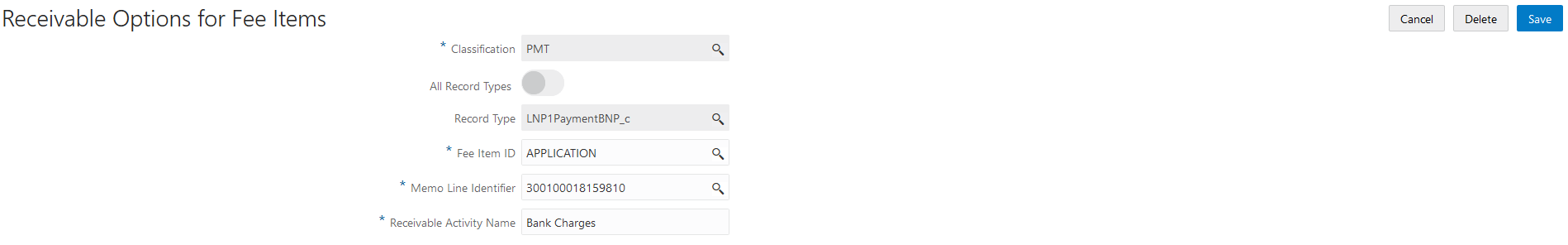

Setting Up Fee Item Receivable Options
Configure your integration with Oracle Receivables at the fee item level.
Use the Receivable Options for Fee Items page to define the receivable information that Public Sector Compliance and Regulation (PSCR) assigns to specific fee items. For more information on the hierarchy used to determine the receivable activity name for payment history lines, see Oracle Receivables Integration Overview.
To access this page select Billing Setup > Fee Item Receivable Options.
Adding Receivable Options for a Fee Item
  1. On the Receivable Options for Fee Items page, click Add.
    This example shows the Receivable Options for Fee Items details page.
    Example of the Receivable Options for Fee Items details page
    Page Element
    Description
    Classification
    Select the offering that the fee item receivable options apply to. Values may include:
    • PMT (Permits)
    All Record Types
    Turn this switch on to apply the receivable options to this fee item for all record types.
    Record Type
    Select the specific record type to which these fee item receivable options apply. This field is unavailable if you turn on the All Records Types switch.
    Fee Item ID
    Select the fee item to which the receivable options apply.
    Enter an invoicing memo line identifier.
    Note: This field is required even though invoicing integration is not currently available.
    Enter the receivable activity name that PSCR assigns to payments with the selected fee item when sending information to Oracle Receivables. Make sure that this value matches the value defined in Oracle Receivables exactly.
  3. Click Save.
