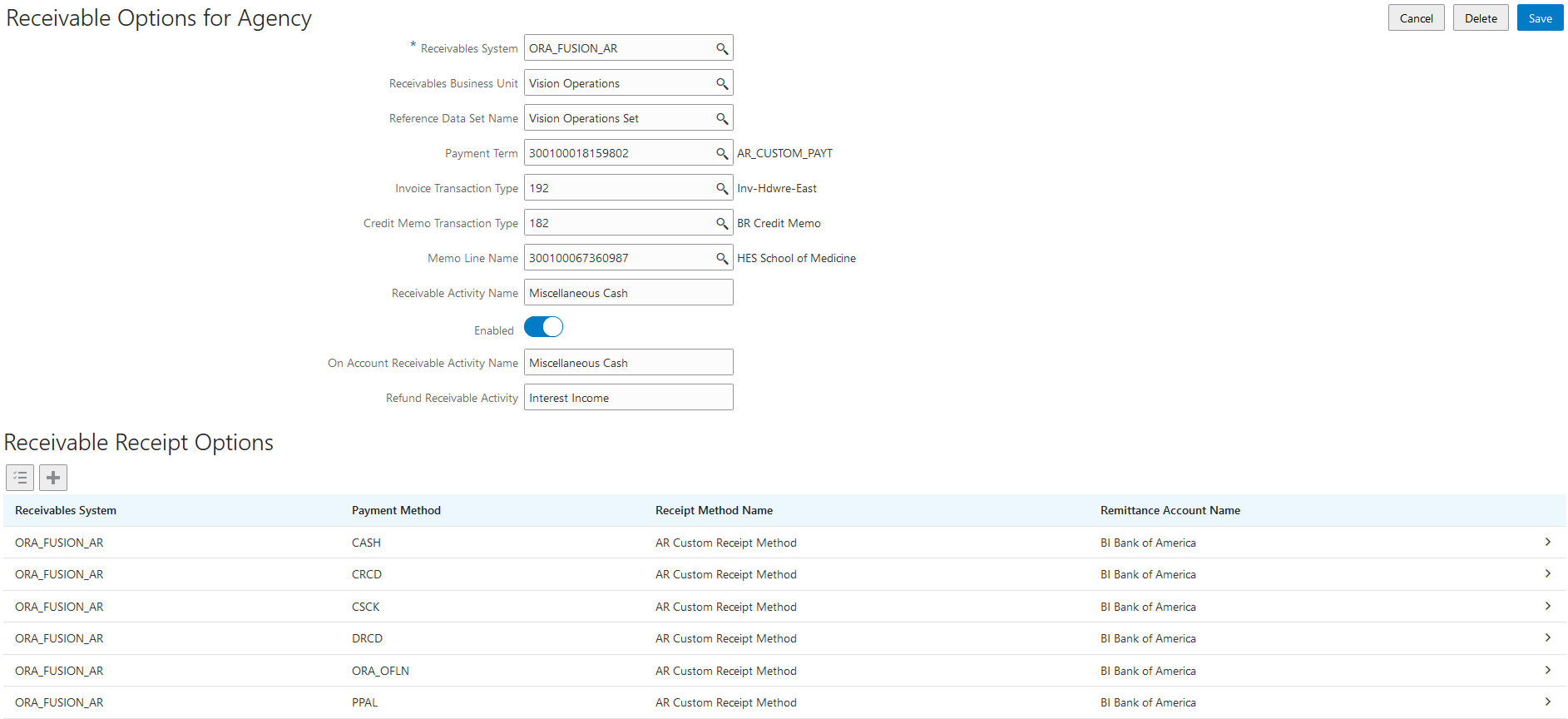

Setting Up Agency Receivable Options
Define how your agency integrates with Oracle Receivables using the Receivable Options for Agency page.
Define Agency Level Receivable Options
Select .
Select the row for your agency.
This example shows the Receivable Options for Agency page.
Enter values for the following fields:
Page Element
Description
Receivables System
Select your Oracle Receivables system.
Receivables Business Unit
Enter the Oracle Receivables business unit associated with your agency.
Reference Data Set Name
Select the set of shared configuration data used across your business units. This value determines the values available for the other setup fields on this page.
Payment Term, Invoice Transaction Type, Credit Memo Transaction Type, Memo Line Identifier
Enter your invoicing information. The reference data set you selected determines the values available to select in these fields.
Note: These fields are required even though invoicing integration is not currently available.Enabled
Turn on this switch to enable the integration between PSCR and Oracles Receivables. When this switch is off, PSCR processes all received payments using normal accounting.
Receivable Activity Name
Enter the default receivable activity name that PSCR assigns to payments that don’t match receivable options defined at the record type or fee item level. Make sure that this value matches the value defined in Oracle Receivables exactly.
On Account Receivable Activity Name
Enter the receivable activity name that PSCR assigns to overpayments. All overpayments for the agency are assigned the same receivable activity name and do not have receivable options set at the record type or fee item level.
Refund Receivable Activity
Enter the receivable activity name that PSCR assigns to refunds. All refunds for the agency are assigned the same receivable activity name and do not have receivable options set at the record type or fee item level.
Note: PSCR generates negative miscellaneous receipts for refunds.Add receivable receipt options for your payment methods.
Click Save.
Adding Receivable Receipt Options
Define a set of receivable receipt options for each payment method that your agency supports.
On the Receivable Options for Agency page, click Add.
This example shows the Receivable Receipt Options page.
Page Element
Description
Receivables System
Payment Method
Select the payment method you are defining receipt options for.
Receipt Method Name and Receipt Account Name
Enter the receipt method name and receipt account name passed to Oracle Receivables for the selected payment method.
Note: Make sure that the values you enter match the values defined in Oracle Receivables exactly.Click Save.

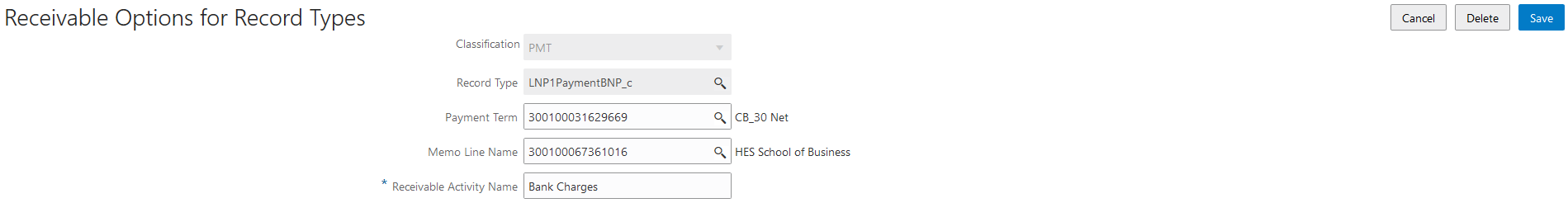

Setting Up Record Type Receivable Options
Configure your integration with Oracle Receivables at the record type level.
Use the Receivable Options for Record Types page to define the receivable information that Public Sector Compliance and Regulation (PSCR) assigns to specific record types. For more information on the hierarchy used to determine the receivable activity name for payment history lines, see Oracle Receivables Integration Overview.
To access this page select .
Adding Receivable Options for a Record Type
On the Receivable Options for Record Types page, click Add.
This example shows the Receivable Options for Record Types details page.
Page Element
Description
Classification
Select the offering that the record type receivable options apply to. Values may include:
LIC (Business Licenses)
PMT (Permits)
PZ (Planning and Zoning)
CE (Code Enforcement)
Record Type
Select the specific record type to which these receivable options apply.
Payment Term and Memo Line Identifier
Enter an invoicing payment term and memo line identifier.
Note: These fields are required even though invoicing integration is not currently available.Receivable Activity Name
Enter the receivable activity name that PSCR assigns to payments with the selected record type when sending information to Oracle Receivables. Make sure that this value matches the value defined in Oracle Receivables exactly.
Click Save.

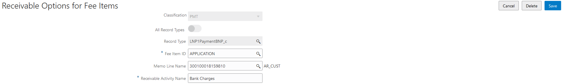

Setting Up Fee Item Receivable Options
Configure your integration with Oracle Receivables at the fee item level.
Use the Receivable Options for Fee Items page to define the receivable information that Public Sector Compliance and Regulation (PSCR) assigns to specific fee items. For more information on the hierarchy used to determine the receivable activity name for payment history lines, see Oracle Receivables Integration Overview.
Adding Receivable Options for a Fee Item
On the Receivable Options for Fee Items page, click Add.
This example shows the Receivable Options for Fee Items details page.
Page Element
Description
Classification
Select the offering that the fee item receivable options apply to. Values may include:
PMT (Permits)
All Record Types
Turn this switch on to apply the receivable options to this fee item for all record types.
Record Type
Select the specific record type to which these fee item receivable options apply. This field is unavailable if you turn on the All Records Types switch.
Fee Item ID
Select the fee item to which the receivable options apply.
Enter an invoicing memo line identifier.
Note: This field is required even though invoicing integration is not currently available.Receivable Activity Name
Enter the receivable activity name that PSCR assigns to payments with the selected fee item when sending information to Oracle Receivables. Make sure that this value matches the value defined in Oracle Receivables exactly.
Click Save.
