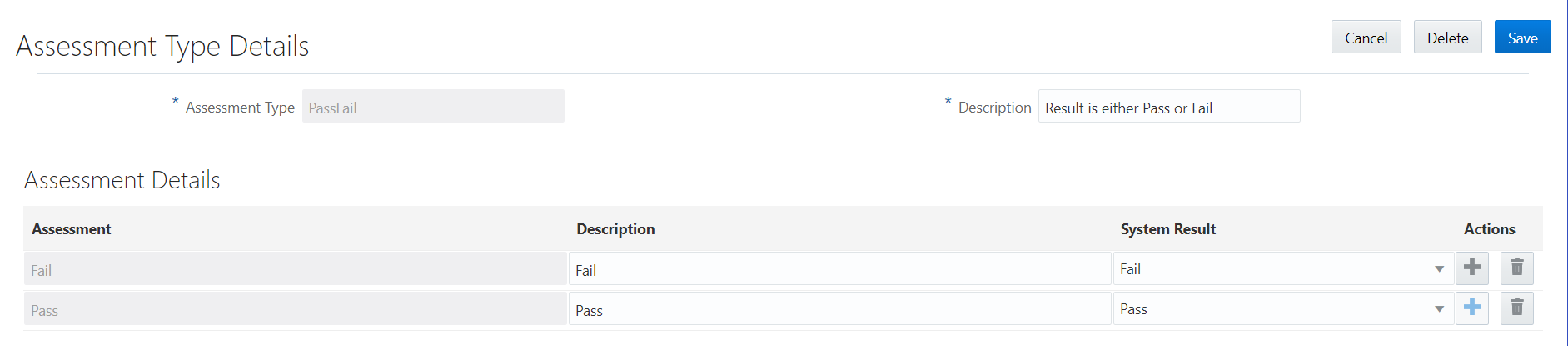

This example illustrates the Assessment Type Details page containing the field values described in the following table.

  5. Enter values in the fields of the assessment code row:
    Elements on the Assessment Type Details page
    Page Element
    Description
    Assessment
    Enter a code name.
    Description
    Enter descriptive text for the code.
    System Result
    Select the system-defined result value that you want to set for this assessment code:
    • Other
    • Pass
    • Fail
    • Corrected
    You must map each assessment code to a system result value. Each assessment type must include a system result of Pass and a system result of Fail. The default value is Other.
    Note: You must assign Fail to only one code. Likewise, you must assign Pass to only one code.
    The system result is used in the inspection result processing. If scoring is used, the system result of Pass and Corrected receive the maximum score. The system results Other and Fail receive no score.
    The system result is also used to determine whether an inspection result is pass (system result Pass) or fail (system result Fail). For example, the Inspection Summary report includes violation information when a checklist or checklist item result is associated with the system result Fail.
