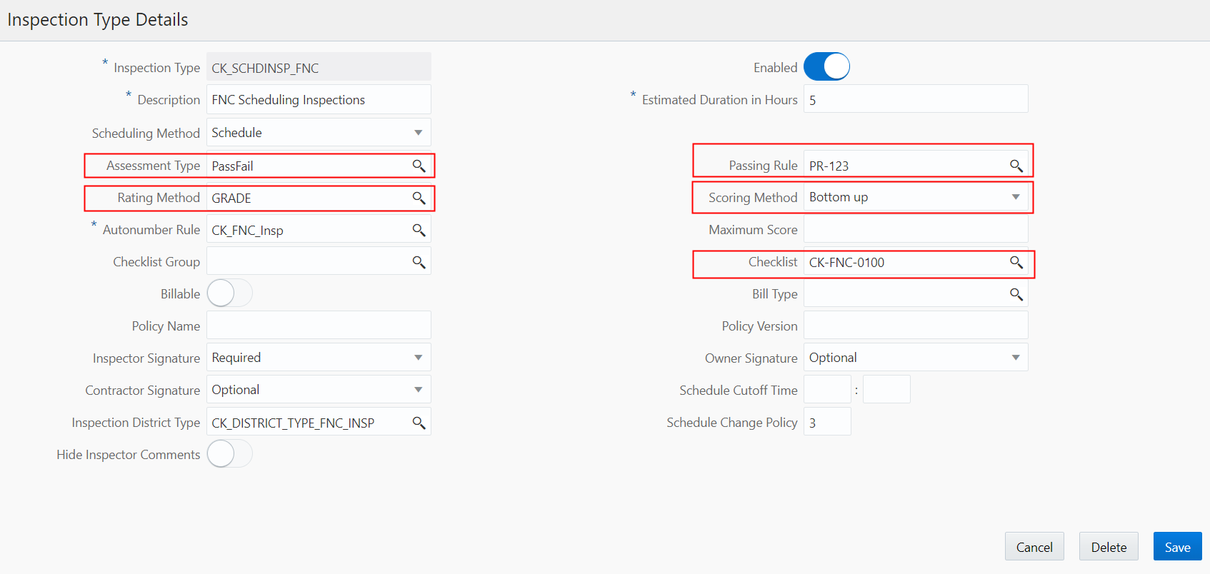

This example illustrates setup for an inspection on the Inspection Type Details page. Details are in the surrounding text.
Example of an inspection type set up with Bottom Up scoring
The setup includes the following:
  1. Assessment Method
    The assessment method is defined on the assessment type page and used in the inspection type definition. During the inspection, the inspector selects an available assessment which is associated with a system result. The system result determines the scoring calculation as follows:
    Example setup on the Assessment Type page and how the scores are calculated
    Displayed Assessment
    System Result
    Scoring Calculation
    Pass
    Pass
    Score = All Points
    Corrected on Site
    Corrected
    Score = All Points
    Fail
    Fail
    Score = No Points
    NA (not applicable)
    Other
    Score = No Points
    Note: Only the displayed assessment value is configurable by the agency. The available system results are Pass, Fail, Corrected, and Other. You must have one assessment with a system result of Pass and one assessment with a system result of Fail. You can define multiple assessments with system results of Corrected and Other.
    See Setting Up Inspection Assessment Types.
  2. Inspection Scoring Method
    The scoring method is defined on the inspection type. In this example, the scoring method is Bottom Up.
    See Setting Up Inspection Types.
  3. Rating Method
    When you use a scoring method, you also must set up a rating method. The rating method defines the range of scores used at the inspection type level.
    See Setting Up Rating Methods.
  4. Checklist
    The checklist used in the inspection is defined on the inspection type. For example, the checklist could be Electrical for a residential addition. For multiple checklists, you enter a checklist group name. A checklist group can have different inspection checklists, such as both Electrical and Plumbing for a residential addition.
    See Setting Up Inspection Checklists.
  5. Checklist Item
    The inspection score is defined in the inspection checklist details. In this example, each checklist item is set up with a possible score of 25. The inspector’s assessment determines how many points are applied to the checklist. When the inspection result is Pass, the item receives the complete score.
    See checklist details in Setting Up Inspection Checklists.
