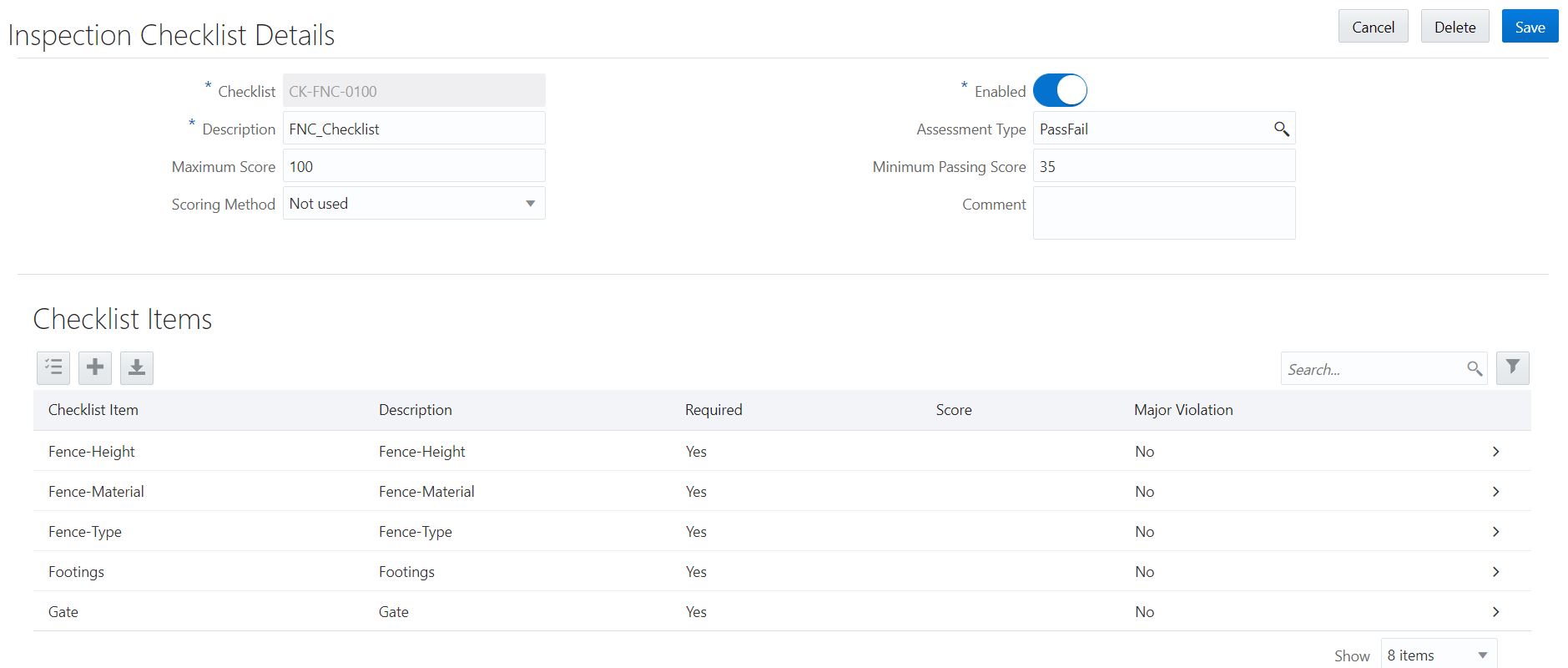

This example illustrates the Inspection Checklist Details page containing the field values described in the preceding table.

On the Inspection Checklist Details page, enter a checklist ID and description.
Verify that the Enabled switch is turned on. The switch is turned on by default for new checklists.
You can also enter values for these fields:
Elements on the Inspection Checklist Details page
Page Element
Description
Assessment Type
Enter an assessment type.
The system determines a passing result based on the assessment type defined for the checklist. The assessment that is defined with system status Pass is used for the passing result. Otherwise, the assessment that is defined with the system status Fail is used.
Assessment types function independently of the scoring method, maximum score, and minimum score.
Maximum Score
Enter the maximum score possible for the checklist. This value is required if the scoring method is Top down, which will be available in a future release.
Minimum Passing Score
Enter a minimum score for a passing grade. This value is required for the scoring method Bottom up.
If the total score for the checklist is equal to or greater than the minimum passing score, the checklist receives a passing result.
Scoring Method
Select a scoring method to be used for the checklist:
Bottom up: Scoring from the bottom up indicates that the scoring starts with zero and the inspector adds points for the criteria that are met.
Not used: This is the default value and indicates that no scoring method is used for this checklist. You must specify the result manually for each level: checklist item, checklist, and inspection.
If you don’t use the scoring method you can’t use the passing rule and rating method. This also means that results are not automatically calculated starting with the checklist items to the checklist to the inspection level.
Note: The scoring method specified for the checklist should match the scoring method in the Inspection Type definition.Comment
Enter any additional information.
Click Save.
