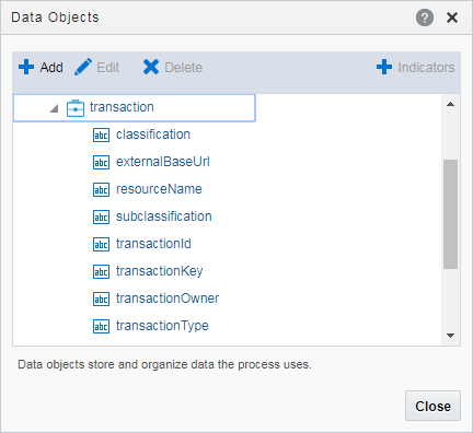

Click the Data Objects button.
Click Add.
On the Create Process Data Object dialog box, make these changes:
Data object values
Field
Value
Name
transaction
Data Type
Business
drop-down list
BusinessData.InitTransaction
Click Create.
This example illustrates the expanded transaction business data object, with the required string data within it.

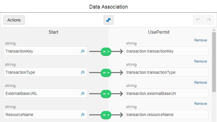

Defining Data Associations for the Start Event
The data associations for the Start event capture identifying information about the transaction for initiating the process instance.
In this task, you map the arguments for the Start event to the data object values you entered for the transaction object.
To set up the data associations:
Open the process definition and select the Start event.
Click the Data Association button.
Set up the following data associations, mapping the Start event arguments to the appropriate attributes in transaction business object.
Start event data associations
Source Data
(Left side of the map)
Target Data
(Right side of the map)
Description
TransactionKey
transaction.transactionKey
The transaction ID.
TransactionType
transaction.transactionType
The transaction type ID.
ExternalBaseURL
transaction.externalBaseURL
The URL for the Public Sector Licensing and Permitting system.
ResourceName
transaction.resourceName
The name of the REST API resource.
TransactionOwner
transaction.transactionOwner
The owner of the transaction.
TransactionId
transaction.transactionId
The transaction ID.
Classification
transaction.classification
The classification of the transaction.
Subclassification
transaction.subClassification
The subclassification of the transaction.
This example illustrates mapping the Start event arguments to the associated data attributes in the transaction business object.
Click Apply.
Click Save.

Defining Data Associations for Retrieving Transaction Type Data
The data associations for a task that retrieves transaction type data provides a structure for storing the retrieved data. In this task you create both input and output data associations.
Access the process definition, and select the system task that retrieves transaction type data.
Set up the following input data associations:
Transaction type data associations — input
Source Data
Target Data
Description
transactionResource
The unique system identifier for the transaction type.
Click Output.
Set up the following output data associations:
Transaction type data associations — output
Source Data
Target Data
Description
body
transactionTypeData
This business object contains all transaction type fields.
Click Apply.
Click Save.

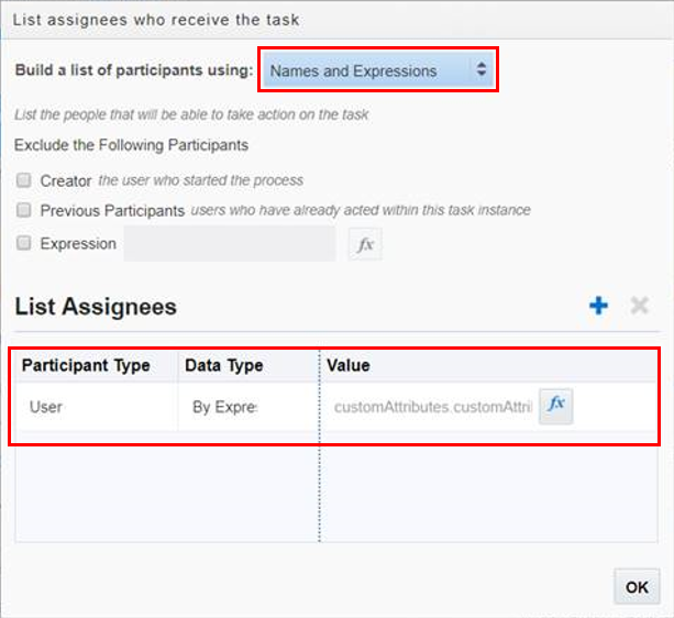

Configuring a Planning and Zoning Human Task to Reference the Assigned Planner Value
If you want to assign the user to a human task, you need to have first setup the Transaction Connector to use the getTransactionAssignee operation.
For more information on setting up the Transaction Connector, see Setting Up the Transactions Connector.
To associate the transaction assignee data to your workflow process:
When configuring the workflow process data object, create a data object to store the output of the service call to getTransactionAssignee.
Locate the first human task in the process after the service call (Start event), and open the Data Association interface.
On the Input Data Association, map the assignee data object to execData.customAttributes.customAttributeString1.
For subsequent human task to which you want to reference the assigned planner, set the Assignee(s) value in the General Properties to customAttributes.customAttributeString1.
Open the properties for the human task.
Select Implementation > General.
Click the Edit icon for the Assignee(s) field.
Select Names and Expressions in the Build a list of participants using list.
Click Add for the List Assignees edit box.,
Select Add User.
Click in the Data Type column, and select By Expression.
Click the fx button in the Value column, and select customAttributes.customAttributeString1.
Click OK.
This example illustrates the settings on the List assignees who receive the task window.
Click Save.
