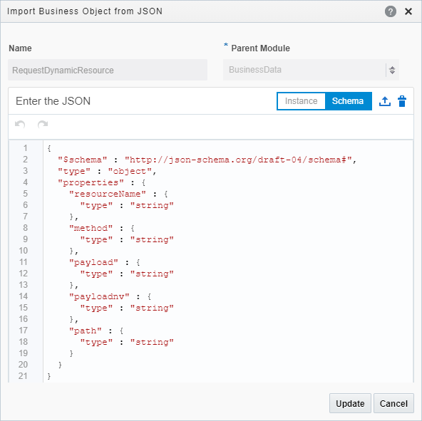

In the Import Business Object from JSON dialog box, enter these values and click Import:
This example illustrates adding the JSON payload for the Sandbox Connector. Details are in the surrounding text.
Page Element
Value
Name
RequestDynamicResource
JSON
Select Schema and add the following JSON.
{ "$schema" : "http://json-schema.org/draft-04/schema#", "type" : "object", "properties" : { "resourceName" : { "type" : "string" }, "method" : { "type" : "string" }, "payload" : { "type" : "string" }, "payloadnv" : { "type" : "string" }, "path" : { "type" : "string" } } }Click the Response button, and from the Body drop-down list, select BusinessData.ResponseTransactionData.

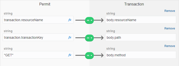

Return to the process definition by collapsing the properties pane, select the same node you selected in the steps above, and this time select Open Data Associations.
Note: You may notice warning text referring to undefined variables, which is what you will resolve in the following step.On the Data Association page, make sure the Input tab is selected, and for the field that reads New Association, enter “GET” and then update the data associations accordingly:
This example illustrates how to map data associations for process definitions. Details are in the surrounding text.
Page Element
Value
transaction.resourceName
body.resourceName
transaction.transactionKey
body.path
“GET”
body.method
