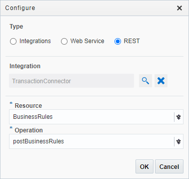

On the new resource, click Add, and select the appropriate operation.
In this case, select POST operation.
Click the newly added operation.
(Optional) Add a different name or additional path.

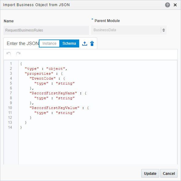

Configure the JSON Request.
In the Response and Request section, select the Request tab, and click Create business object under the Body field to open the Import Business Object from JSON dialog box.
For Name enter a recognizable name for the request, such as RequestBusinessRules.
In the Enter the JSON edit box, select Schema.
Copy and paste the following JSON.
{ "type" : "object", "properties" : { "EventCode" : { "type" : "string" }, "RecordFirstKeyName" : { "type" : "string" }, "RecordFirstKeyValue" : { "type" : "string" } } }This example illustrates the request JSON.
Click Import.
Close the Import Business Object from JSON dialog box.

Confirm the integration is referencing the correct operation.
Select the task and click Open Properties.
Select Implementation, General and then click Configure for the Service Call.
This example illustrates the integration step referencing the REST operation.

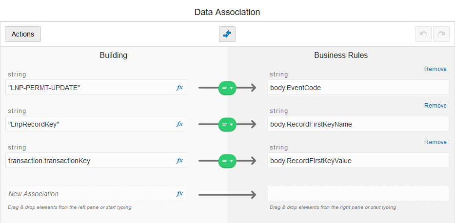

Configure data associations.
Select your integration task and select Open Data Association.
On the Data Association page, select the Input tab.
Map the following process definition data attributes to your Business Rules integration attributes, and click Apply and Save.
Data Object
Integration
"LNP-PERMT-UPDATE"
or
"PZ-PLANNING-UPDATE"
Enter these values manually, depending on whether this process definition is being used for Permits or Planning and Zoning.
body.EventCode
"LnpRecordKey"
Enter this value manually.
body.RecordFirstKeyName
transaction.transactionKey
body.RecordFirstKeyValue
This example illustrates that data associations between the transaction and the business rules integration.
