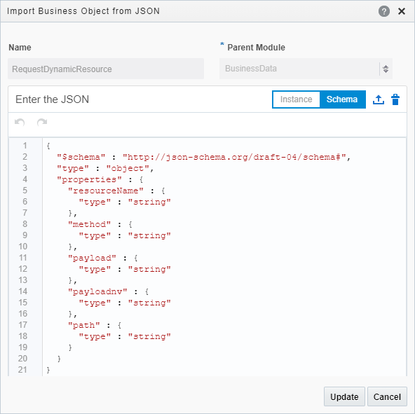

In the Resources > Resource box, scroll to the Request/Response area, the Request button will already be selected. Click the plus sign (Create a business object).
In the Import Business Object from JSON dialog box, enter these values and click Import:
This example illustrates adding the JSON payload for the Sandbox Connector. Details are in the surrounding text.
Page Element
Value
Name
RequestDynamicResource
JSON
Select Schema and add the following JSON.
{ "$schema" : "http://json-schema.org/draft-04/schema#", "type" : "object", "properties" : { "resourceName" : { "type" : "string" }, "method" : { "type" : "string" }, "payload" : { "type" : "string" }, "payloadnv" : { "type" : "string" }, "path" : { "type" : "string" } } }Click the Response button, and from the Body drop-down list, select BusinessData.ResponseTransactionData.
Click Apply to save your changes.

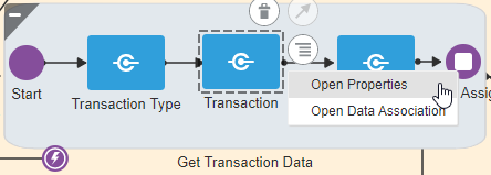

Select Processes in the left-hand navigation to display the process.
Expand the Get Transaction Data node in the process definition, select the transaction data node, and select Open Properties.
This example illustrates a collapsed process definition node. Details are in the surrounding text.
This example illustrates an expanded process definition node. Details are in the surrounding text.
Note: This node can have other names, such as Get Application, Get Permit Data, and so on. It is typically the first system task in the process definition, where the process definition gets the required initial data, including transaction type, transaction data, and so on.From the Type drop-down list, select Service Call, and click the Configure button.

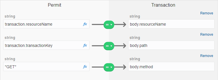

Return to the process definition by collapsing the properties pane, select the same node you selected in the steps above, and this time select Open Data Associations.
Note: You may notice warning text referring to undefined variables, which is what you will resolve in the following step.On the Data Association page, make sure the Input tab is selected, and for the field that reads New Association, enter “GET” and then update the data associations accordingly:
This example illustrates how to map data associations for process definitions. Details are in the surrounding text.
Page Element
Value
transaction.resourceName
body.resourceName
transaction.transactionKey
body.path
“GET”
body.method
