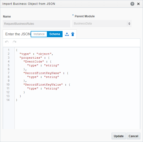

Click Request
Click the + icon next to the Body field to open the Import Business Object from JSON window.
Enter RequestTransStatusUpdate in the Name field.
Click Schema.
Click the Import from File icon next to the Schema button.
Locate and upload the RequestTransStatusUpdate.json file that you downloaded from My Oracle Support.
The imported JSON code appears in the Import Business Object from JSON window.
Click the Import button at the bottom of the window to save the code and close the window.

Click Response.
Enter ResponseTransStatusUpdate in the Name field.
Click Schema.
Locate and upload the ResponseTransStatusUpdate.json file that you downloaded from My Oracle Support.

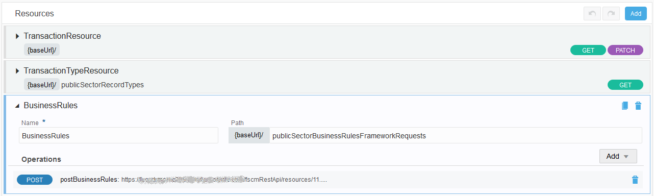

Step 11: Add the POST Operation for the Business Rules Request
This step describes how to configure integration with Oracle Permitting and Licensing by calling REST resources directly from workflow process definitions.
Generally, any REST API can be called from your workflow process definition. There are multiple REST API’s provided with the Oracle Permitting and Licensing offerings. The sample workflow models provided to get you started include only a handful of the integrations that could be configured, depending on your business requirements.
Each process definition has a set of connectors that you can view on the Integrations tab. In the sample workflow process definitions and documentation the each connector is separated to make it easier to view and describe. However, you may choose to combine all the individual connectors into a single connector.
This procedure outlines how you can configure additional integrations within process definitions to call Oracle Permitting and Licensing REST APIs to incorporate more data to drive your workflow process. This example demonstrates how to configure an integration with a Business Rules Framework API.
For more information on the Business Rules Framework, see Business Rules Framework Overview.
To set up an integration:
Open the Transaction Connector.
In the Resources box, click Add.
Expand the added resource and enter these values:
Page Element
Description
Value
Name
The name of the integration or connector. You can enter a custom name as needed.
BusinessRules
Path
The name of the REST resource you intend to call.
publicSectorBusinessRulesFrameworkRequests
This example illustrates adding a Business Rules resource.
On the new resource, click Add, and select the appropriate operation.
In this case, select POST operation.
Click the newly added operation.

Configure the JSON Request.
In the Response and Request section, select the Request tab, and click Create business object under the Body field to open the Import Business Object from JSON dialog box.
For Name enter a recognizable name for the request, such as RequestBusinessRules.
In the Enter the JSON edit box, select Schema.
Copy and paste the following JSON.
{ "type" : "object", "properties" : { "EventCode" : { "type" : "string" }, "RecordFirstKeyName" : { "type" : "string" }, "RecordFirstKeyValue" : { "type" : "string" } } }
This example illustrates the request JSON.
Click Import.
Close the Import Business Object from JSON dialog box.
