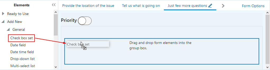

Working with the Drop Zone
The drop zone is the area of the issue subtype intake form where you can add user-defined fields and group boxes. You can locate drop zones by selecting the page tabs with the pencil icon.
This example illustrates the pencil icon on a page tab, which indicates which tab(s) a drop zone resides where you can add custom fields.
The drop zone is the only area on the form that you can add and configure group boxes and fields.
You can drag and drop these form elements into a drop zone:
User-defined fields
Group boxes
This example illustrates dragging and dropping a user-defined field type from the Elements panel into the drop zone.
The drop zone itself is a group box into which you can drag user-defined fields and other group boxes if needed.
While the drop zone is technically a group box, you can’t modify its attributes or remove it from the page.

Expand the Add New list in the Elements panel.
In the General list, select Switch, and drag and drop it in the drop zone.
This example illustrates dragging and dropping a field type into the drop zone.
