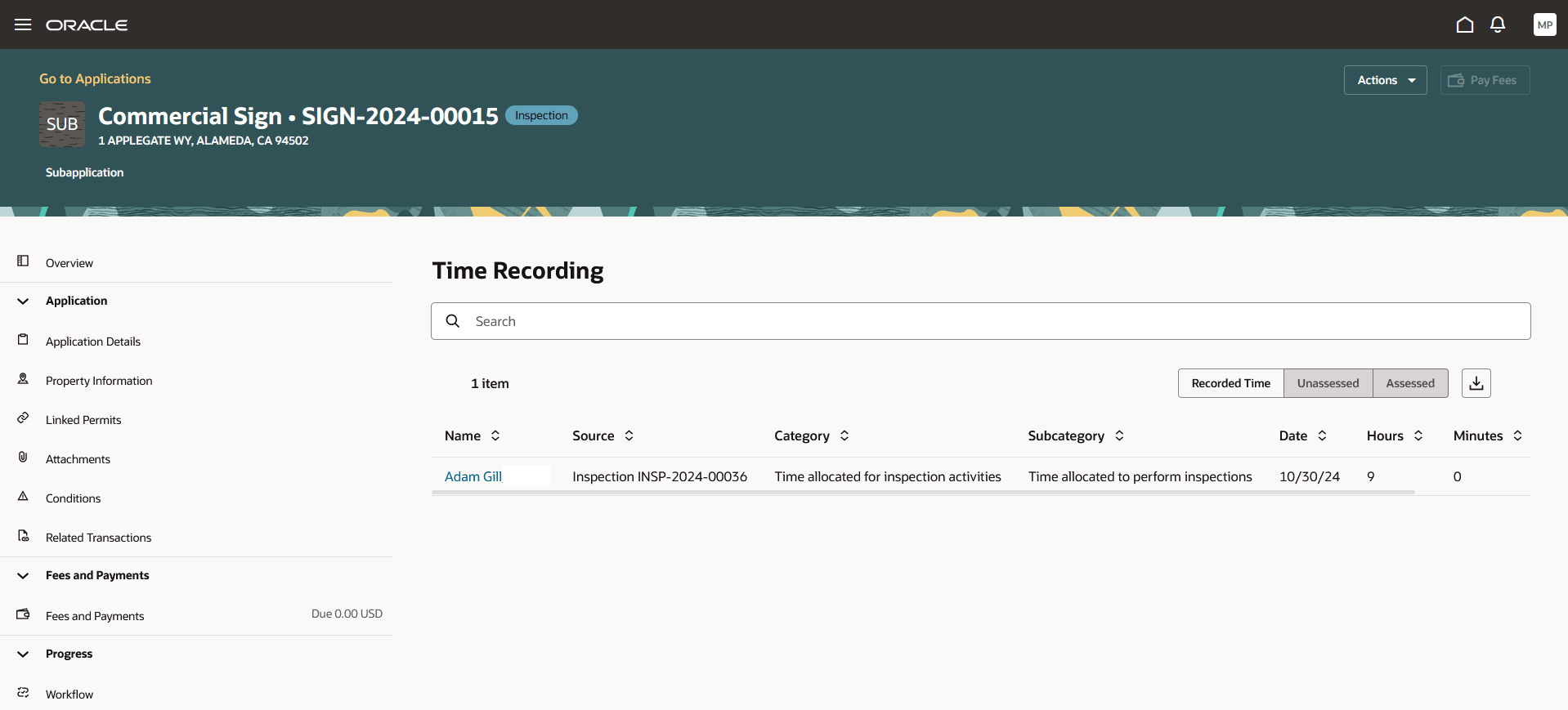

This example illustrates a time entry that was recorded for a permit inspection.

Click the Time Recording menu item in the left navigation panel to view the Time Recording page.
Use the search or filters for finding or viewing the time entries.
Page Element
Description
Search
Enter identifying text in the lookup field. Remove the search text or click the Clear All Filters button if no matching time records were found.
Recorded Time
Click to display all associated time records.
Unassessed
Click to view time records with unassessed fees.
Assessed
Click to view time records with fees that have been assessed.
You can also click the Export button to download the list of time entries.
