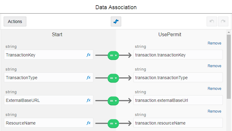

Defining Data Associations for the Start Event
The data associations for the Start event capture identifying information about the transaction for initiating the process instance.
In this task, you map the arguments for the Start event to the data object values you entered for the transaction object.
To set up the data associations:
  1. Open the process definition and select the Start event.
  2. Click the Data Association button.
  3. Set up the following data associations, mapping the Start event arguments to the appropriate attributes in transaction business object.
    Source Data
    (Left side of the map)
    Target Data
    (Right side of the map)
    Description
    TransactionKey
    transaction.transactionKey
    The transaction ID.
    TransactionType
    transaction.transactionType
    The transaction type ID.
    ExternalBaseURL
    transaction.externalBaseURL
    The URL for the Oracle Permitting and Licensing system.
    ResourceName
    transaction.resourceName
    The name of the REST API resource.
    TransactionOwner
    transaction.transactionOwner
    The owner of the transaction.
    TransactionId
    transaction.transactionId
    The transaction ID.
    Classification
    transaction.classification
    The classification of the transaction.
    Subclassification
    transaction.subClassification
    The subclassification of the transaction.
    This example illustrates mapping the Start event arguments to the associated data attributes in the transaction business object.
    Start event arguments mapped to their counterpart data attribute in the transaction data object
  4. Click Apply.
  5. Click Save.

Defining Data Associations for Retrieving Transaction Type Data
The data associations for a task that retrieves transaction type data provides a structure for storing the retrieved data. In this task you create both input and output data associations.
  1. Access the process definition, and select the system task that retrieves transaction type data.
  3. Set up the following input data associations:
    Source Data
    Target Data
    Description
    transactionResource
    The unique system identifier for the transaction type.
  4. Click Output.
  5. Set up the following output data associations:
    Source Data
    Target Data
    Description
    body
    transactionTypeData
    This business object contains all transaction type fields.
  6. Click Apply.
  7. Click Save.
