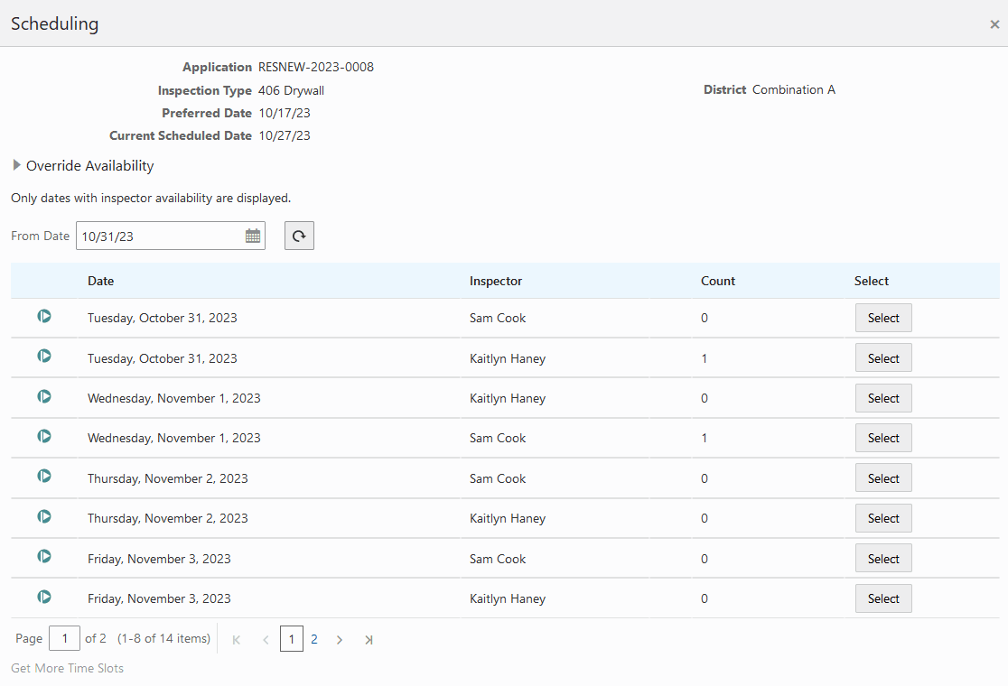

Your agency may also limit the number of daily inspections based on a count of inspections that are scheduled using a date only. The Inspection Count Limit field is the agency setting used to alert inspection supervisors when an inspector's total permit and business license inspections for the day exceeds the maximum defined. All of the inspections assigned to an inspector that aren't in a canceled or completed status are tallied. Inspectors below the limit can be assigned using automatic assignment, however, inspector supervisors can override the maximum number when manually assigning inspections. You must have an inspection supervisor job role to see inspector names and counts when scheduling inspections; an alert icon appears next to the count on the schedule page when an inspector has reached the daily limit. Automatic intspector assignment will not assign to inspectors who have reached their limit. For more information, see Setting Up Inspection Assignment.

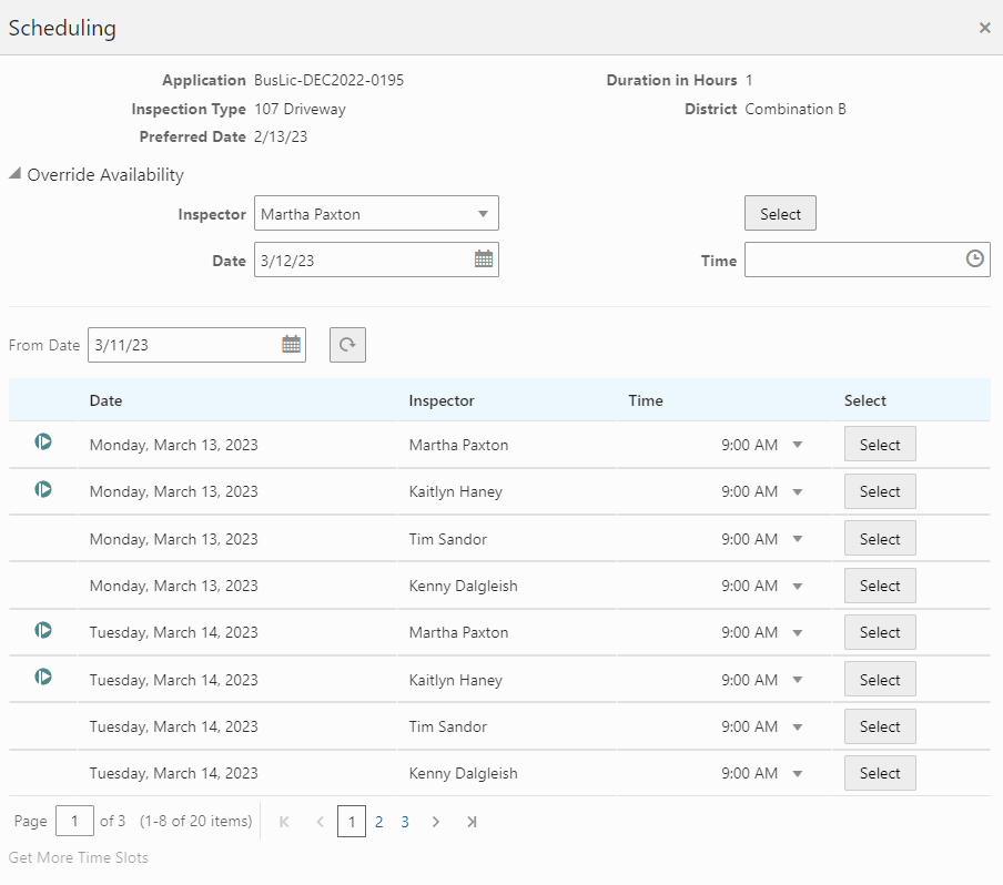

This example in the classic interface illustrates the Scheduling modal page for an inspections supervisor. Inspections supervisors can see the inspector names and override availability.
This example in the classic interface illustrates the Scheduling modal page for an inspection that has been configured to use the count assignment method. An icon (not shown here) will be displayed next to the Count value for an inspector who has reached the limit. Only inspector supervisors can see the inspector name and count columns.
Select an available Time from the drop-down list and click Select next to the inspector and date on which you want to schedule the inspection. Depending on the time entry method set up for the scheduling method, you may only be able to select a date or a date and time range.
Note:A flag icon appears next to preferred inspectors.
If an inspector isn't available for the date and time that you want, inspections supervisors can expand the Override Availability section of the modal page to manually assign an inspector for a specific date and time. Select the Inspector, Date, and Time and click Select to assign the inspection. This is useful when supervisors need to load balance inspectors and ensure that each inspection is assigned to an inspector.
