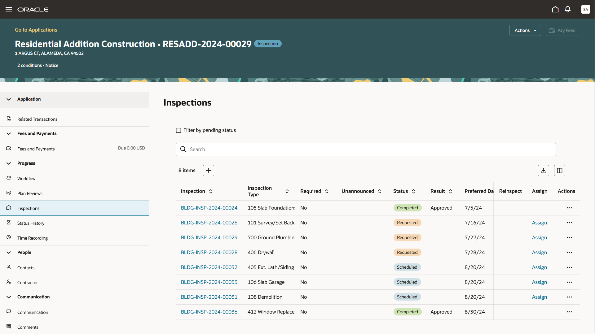

Viewing Inspection Activity
Here's how to view the inspections associated with a permit.
  1. After you access the permit, expand the Progress section in the left navigation panel.
  2. Click the Inspections menu item in the left navigation panel to open the inspections list for the permit.
  3. On the permit's Inspections list page, use the search or filter for finding or viewing the inspections in the grid. Enter text in the search field or use delivered filters, such as the status or completed date range, when available.
    Remove the search text if no matching inspections were found.
  4. Here's how you can monitor inspection activity in the grid:
    Page Element
    Description
    Inspection
    Displays the inspection number. Click the inspection number link or row to open the inspection details pages. Inspection numbers are automatically generated based on the autonumbering definition in the inspection type.
    Inspection Type

  5. Click the three-dot Actions icon button in the inspection row to view the available menu items for the inspection based on your permissions and the inspection status.
