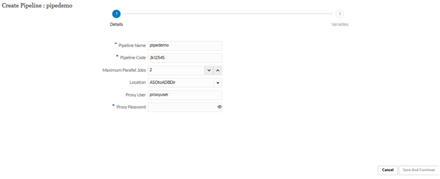

To create a proxy server user credential, an administrator with a service administrator role (can grant user roles), specifies a proxy admin username on the Create Pipeline page. If the proxy user name is different than the service administrator's username, then the system prompts the user to enter a password.

The new proxy administrator user credential options are shown below:
Image Shows The Create Pipeline Page
