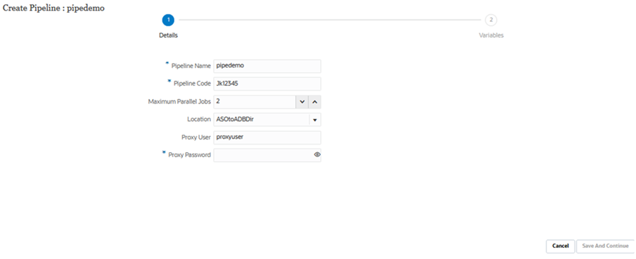

The new proxy administrator user credential options are shown below:
Image Shows The Create Pipeline Page.
