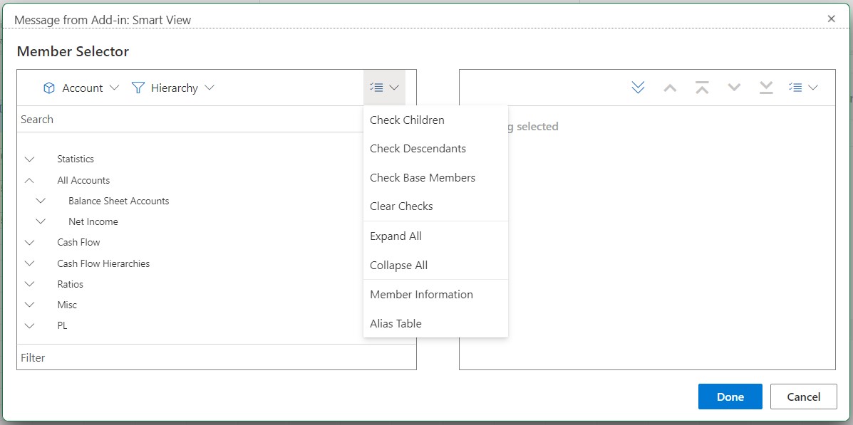

New options in the Actions menu:
The following options are now available in the Actions menu:
  • Check Children, Check Descendants, and Check Base Members: Place a check in the check box next to the applicable members, that is children, descendants, or base members of a selected member.
  • Clear Checks: Clear all check marks.
  • Expand All and Collapse All: View the member hierarchy in expanded or collapsed form.
  • Member Information: View information about a selected member from the Members list.
  • Alias Table: View alias table information, if available, and change alias table.
New options in the Action menu
Business Benefit: These enhancements improve usability and offer more actions to use the Member Selector effectively.
