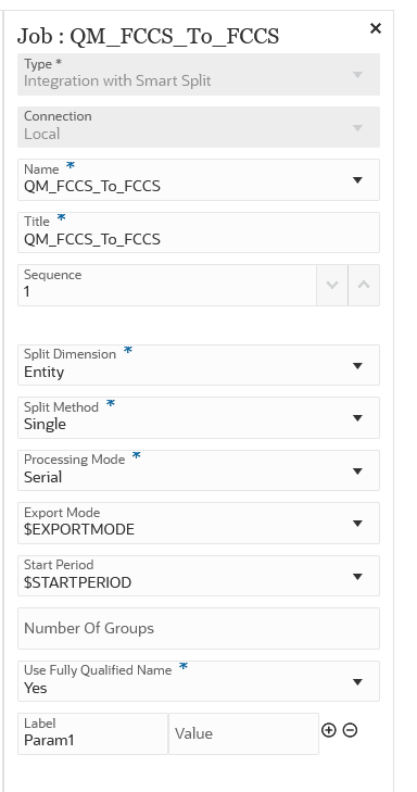

In the following example, the Split Dimension has been placed on the “Entity” dimension in the source application. The Split method is “Single” and instructs the system to run a separate process for each member in the dimension.
Image shows the Integration with Smart Split job type in the Pipeline
