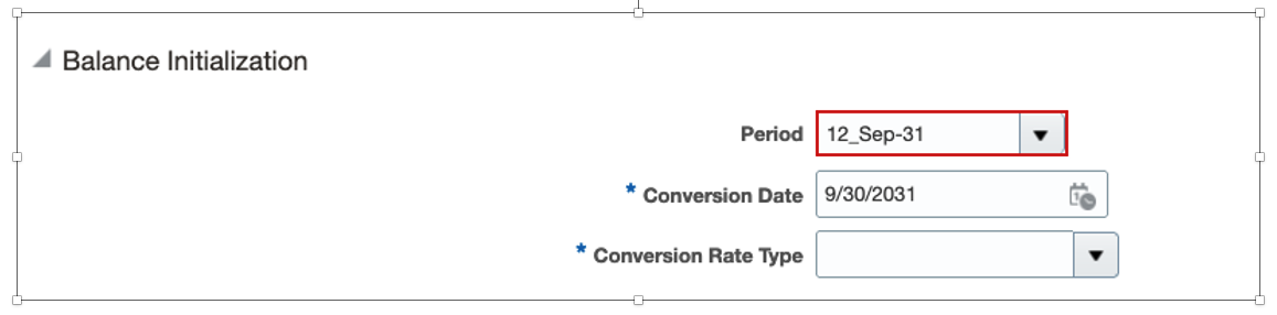

  1. Enable balance initialization for the target ledger (secondary ledger or reporting currency) by selecting the pre-populated balance initialization period during the setup of the new secondary ledger or reporting currency. Select the pre-populated Balance Initialization Period along with the Conversion Date and Conversion Rate Type for determining the rates to initialize the balances from the source ledger to the target ledger.
