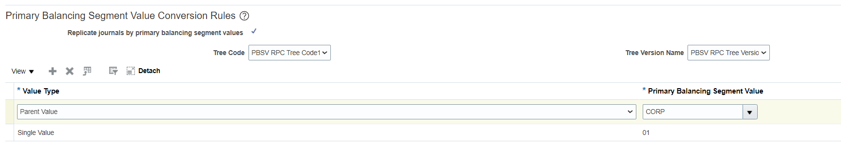

You can navigate to the Map Primary to Secondary Ledger page to define the mapping and the conversion rules between primary and secondary ledgers. For the Journal and Subledger-level data conversion level mapping, you can now define primary balancing segment value conversion rules.
Here are the steps to define primary balancing segment value conversion rules.
  1. Navigate to the Map Primary to Secondary Ledger page and enable the checkbox Replicate journals by primary balancing segment values in the Primary Balancing Segment Value Conversion Rules section.
  1. You can enter the child and parent primary balancing segment values by selecting the value type as Single Value and Parent Value. The Primary Balancing Segment Value field will show all the child values or parent values applicable to the value type.  If you would like to define the primary balancing segment values based on parent values, then you must select a tree code and version.
  1. You can search the primary balancing segment values based on the value, description or legal entity.
