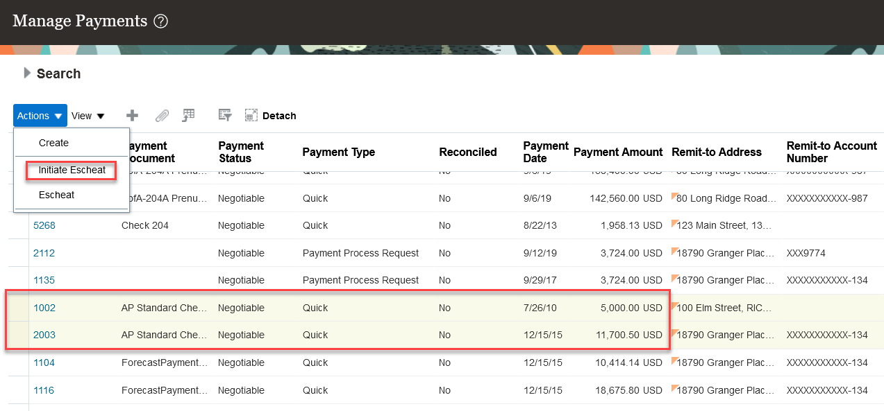

  1. Identify the stale dated check payments in Manage Payments page using payment date criteria. Checks that aren’t cleared for more than or equal to the minimum number of days for escheatment are considered as stale dated check payments.
Identify the Stale Dated Payments in Manage Payments Page
  1. Select "Initiate Escheat" action on a single payment or selected multiple payments identified as stale dated check payments. After payment is Initiated for escheatment, the payment status will be changed to Escheatment Initiated.
Initiate Escheatment from Manage Payments Page

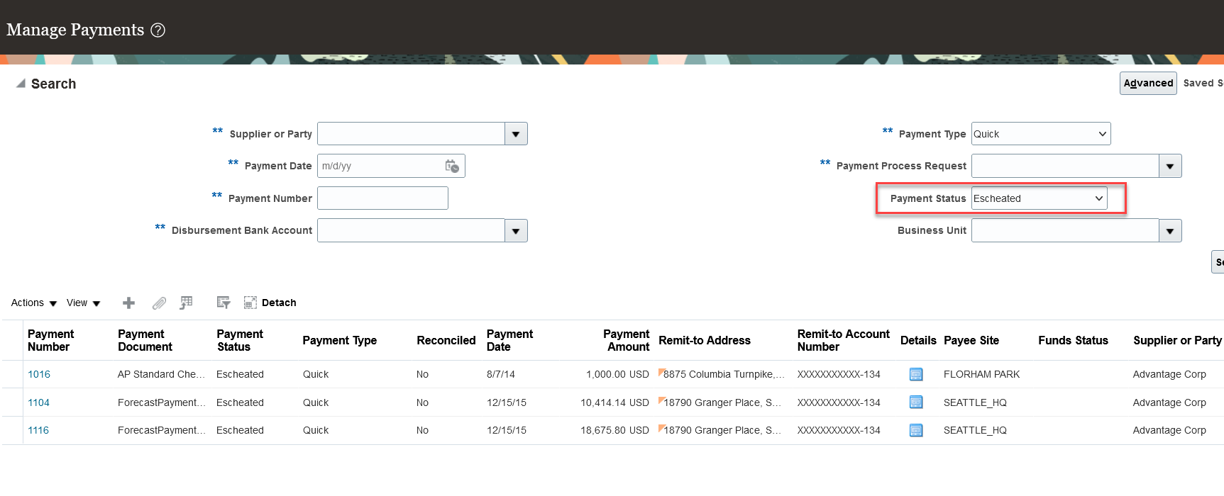

  1. After performing due diligence on all stale dated payments, use the Manage Payments page to search for and select payments in the Escheatment Initiated status in and submit the Escheat action.
Escheat Payments Which Are in Escheatment Initiated Status
  1. The payments status changes to Escheated. There is no further activity on escheated payments.
Escheated Payments
Escheated Payments

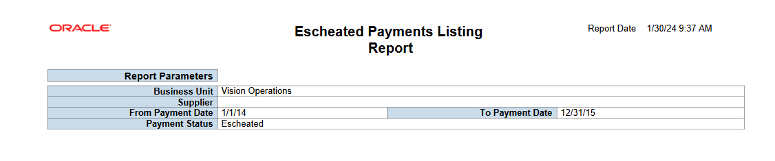

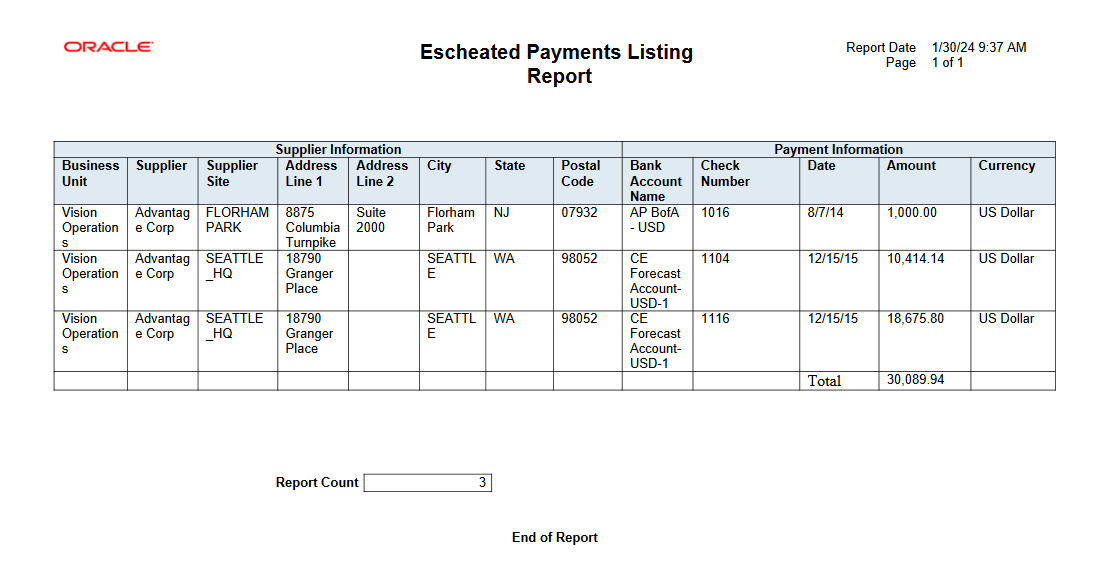

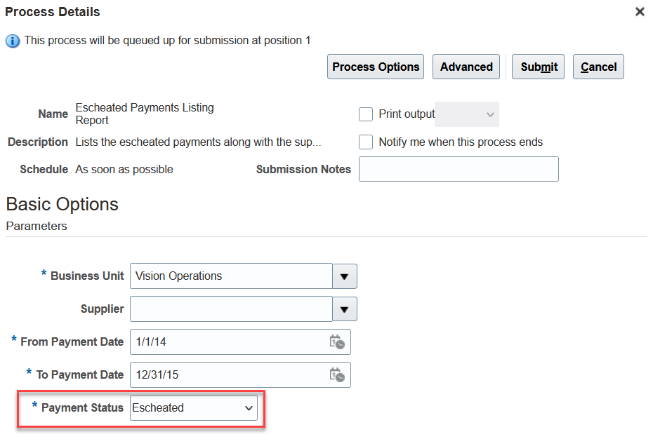

Report:
Run the Escheated Payments Listing Report for a list of Escheated and Initiated for Escheatment payments.
Report Output:
Report Output
Report Output
Report Output

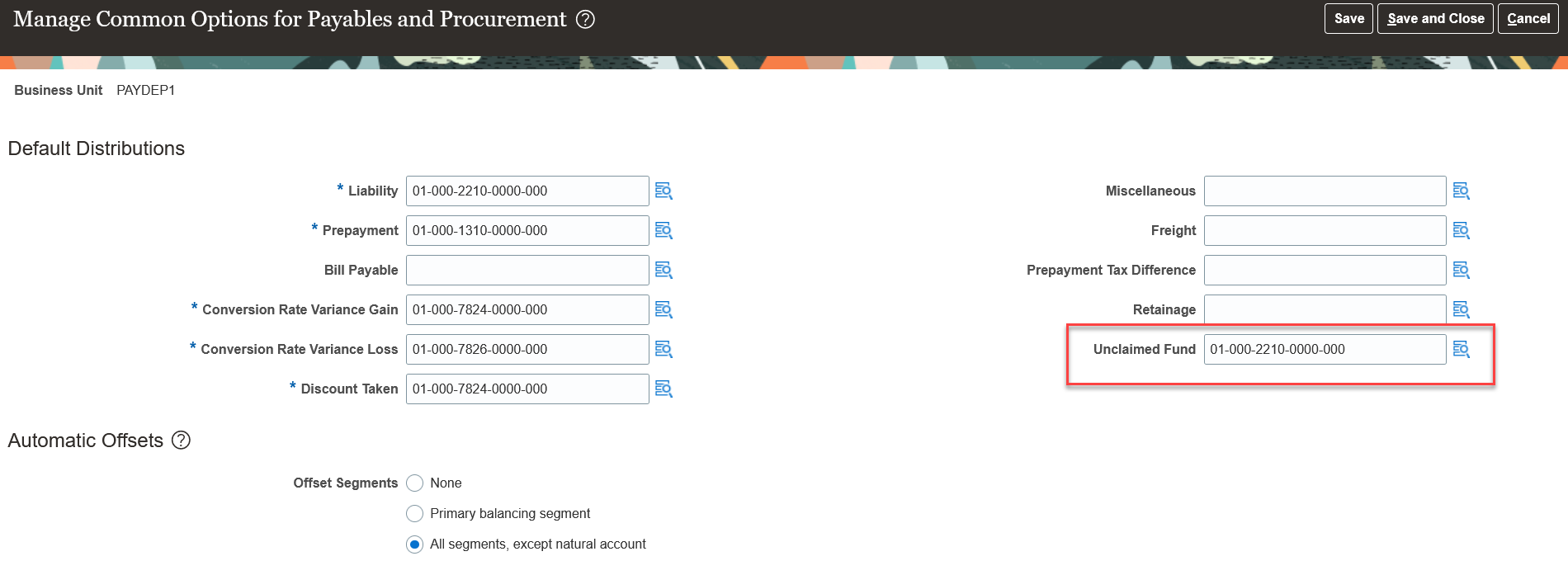

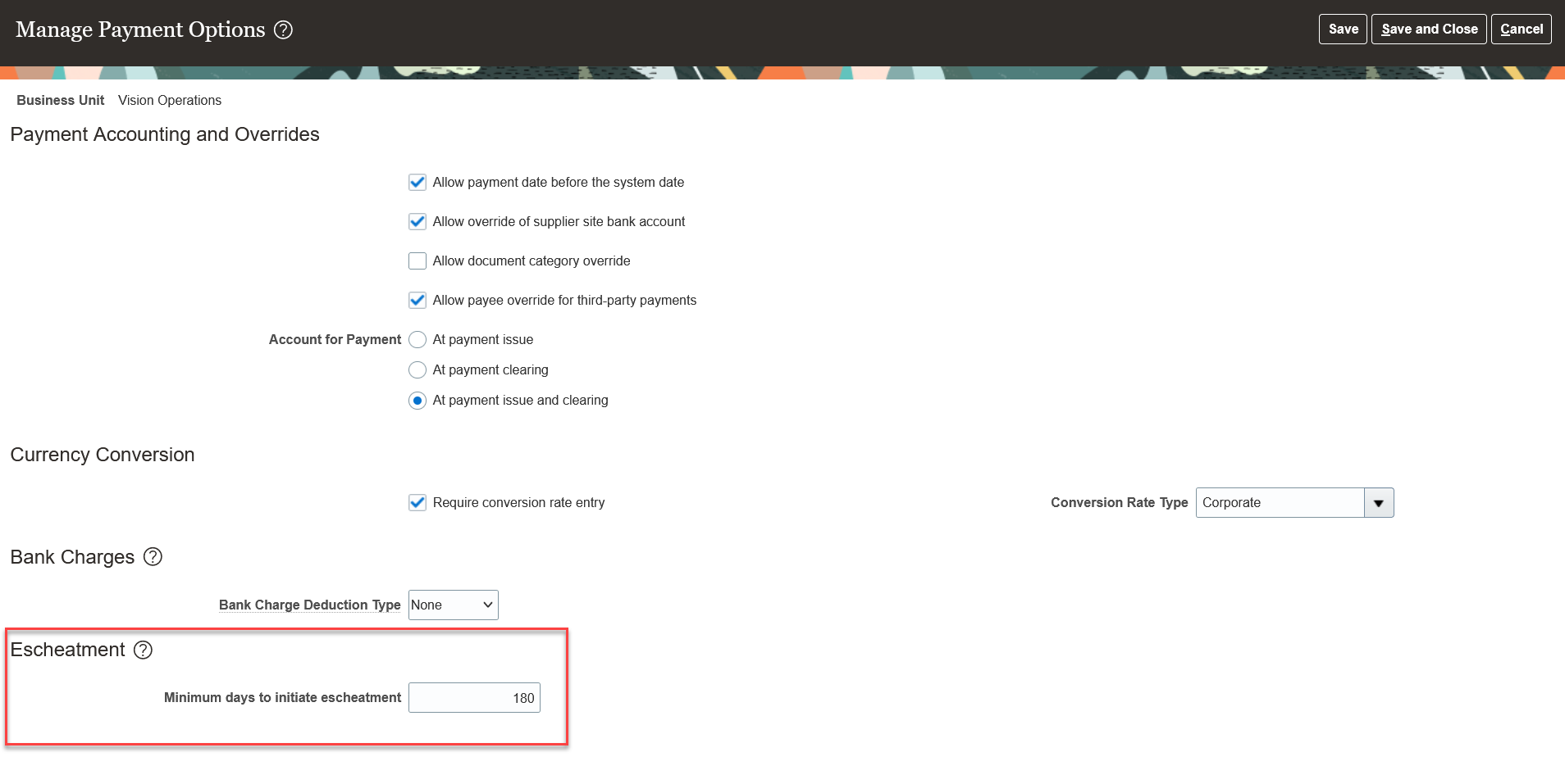

Following setups are mandatory to escheat the payments:
  1. Enter Unclaimed Fund Account in Manage Common Options for Payables and Procurement page.
Manage Common Options for Payables and Procurement Page
  1. Enter minimum days to initiate escheatment in Manage Payment Options page.
