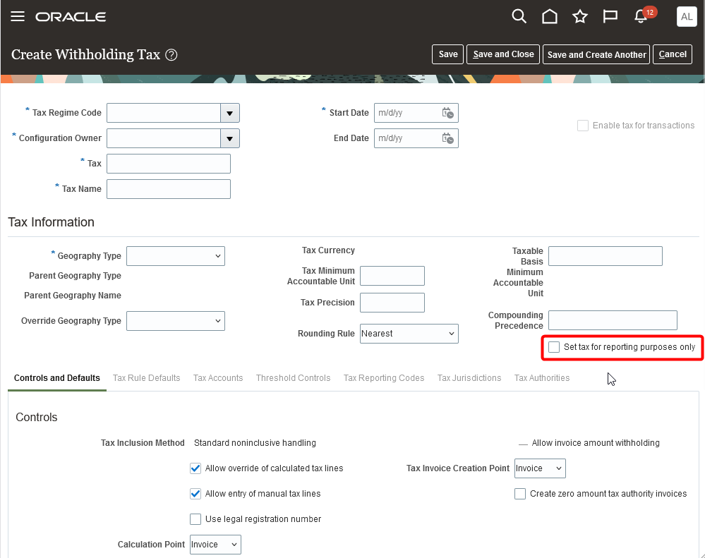

When you create a new withholding tax, enable the "Set tax for reporting purpose only" option to indicate that this withholding tax is for reporting purposes only. Enabling this option ensures that the tax is not accounted and doesn't affect the transaction totals.
Create Withholding Tax page

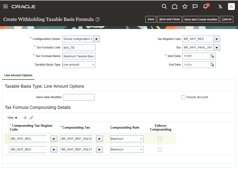

Withholding Taxable Basis Formula
The taxable basis tax formulas are used in the tax calculation process. These formulas help determine the taxable basis amount to consider for a given transaction line.
The taxable basis type, defined in the taxable basis formula, decides the characteristics of the taxable basis amount. The various taxable basis types are:
- Assessable value. Use Assessable value when the transaction line amount doesn't reflect the correct taxable basis from the tax calculation perspective. The assessable value given on the transaction line is considered as the taxable basis amount to calculate tax.
- Line amount. Use Line amount when the transaction line amount is to be treated as the taxable basis to calculate tax.
- Prior Tax. Use Prior tax when there are one or more taxable basis basis amounts, other than the taxes calculated on the transaction line. The option to compound the prior taxes that are calculated on the transaction line is also available.
The tax details specified in the compounding region can be used to define the final taxable basis. The compounding rules are as follows:
- Minimum: Replaces the taxable basis by the minimum taxable basis amount of the compounding tax lines.
- Maximum: Replaces the taxable basis by the maximum taxable basis amount of the compounding tax lines.
- Add Minimum: Add the minimum taxable basis amount of the compounding tax lines to the taxable basis.
- Add Maximum: Add the maximum taxable basis amount of the compounding tax lines to the taxable basis.
- Subtract Minimum: Subtract the minimum taxable basis amount of the compounding tax lines from the taxable basis.
- Subtract Maximum: Subtract the maximum taxable basis amount of the compounding tax lines from the taxable basis.
- Add: Add the taxable basis amount of the compounding tax lines to the tax taxable basis.
- Subtract: Subtract the taxable basis amount of the compounding tax lines from the tax taxable basis.
In the example below, the system calculates the taxable basis for the BR_WHT_REP_ONLY1 tax and the BR_WHT_REP_ONLY2 tax and uses the maximum amount as the taxable basis for the BR_WHT_FINAL_TAX tax.
Withholding Taxable Basis Formula example
