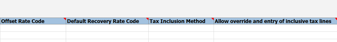

Use the additional columns in Tax Rapid Implementation to enter information related to tax rate controls and offset tax and recovery rates.
The following fields are included in the Manage Rates worksheet of the tax configuration workbook and the tax rates template spreadsheet.
- Offset Rate Code
- Default Recovery Rate Code
- Tax Inclusion Method
- Allow override and entry of inclusive tax lines
