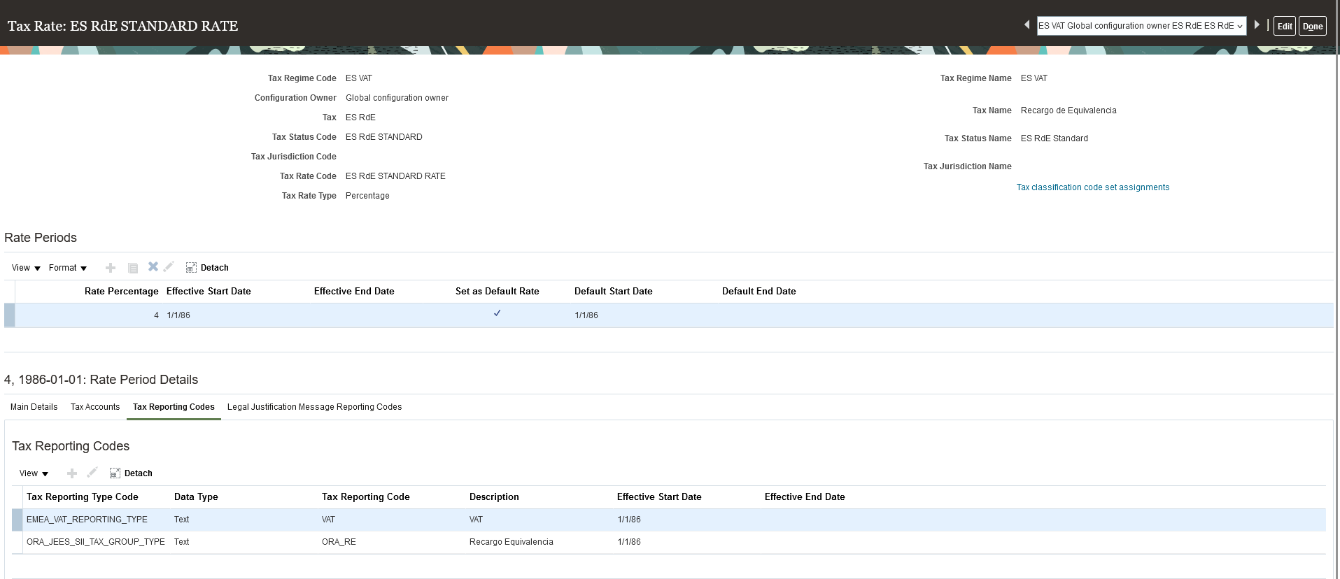

You must use the existing Tax Reporting Type ORA_JEES_SII_TAX_GROUP_TYPE for the SII feature, with the new tax reporting code ORA_RE to identify the tax rates used to calculate the equivalence surcharges. These rates are calculated on Receivables transactions on top of the standard VAT rates.
Use of Tax Reporting type ORA_JEES_SII_TAX_GROUP_TYPE, code ORA_RE to identify a tax rate as equivalence surcharge
