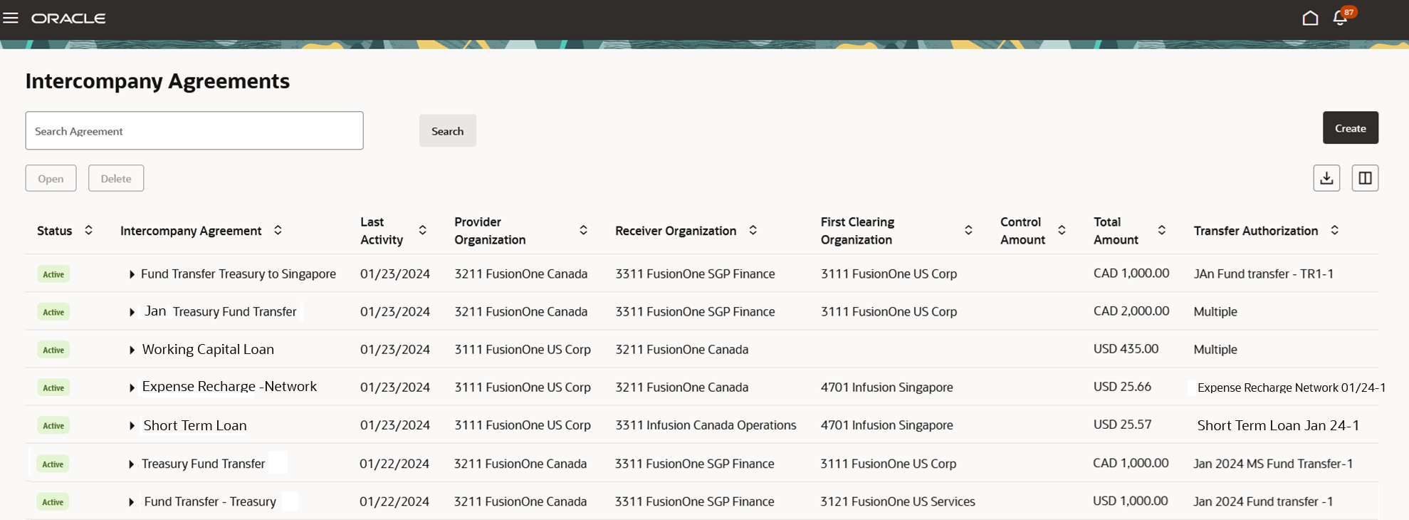

Use the Intercompany Agreement landing page to manage all intercompany agreements.
Multitier Intercompany Operations Landing Page

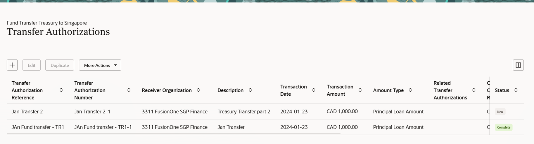

A transfer authorization is a specific instance of fund transfer between the organizations. In the below example, the authorization is for initiating transfer of funds for treasury purpose.
Transfer Authorization to initiate the fund transfer

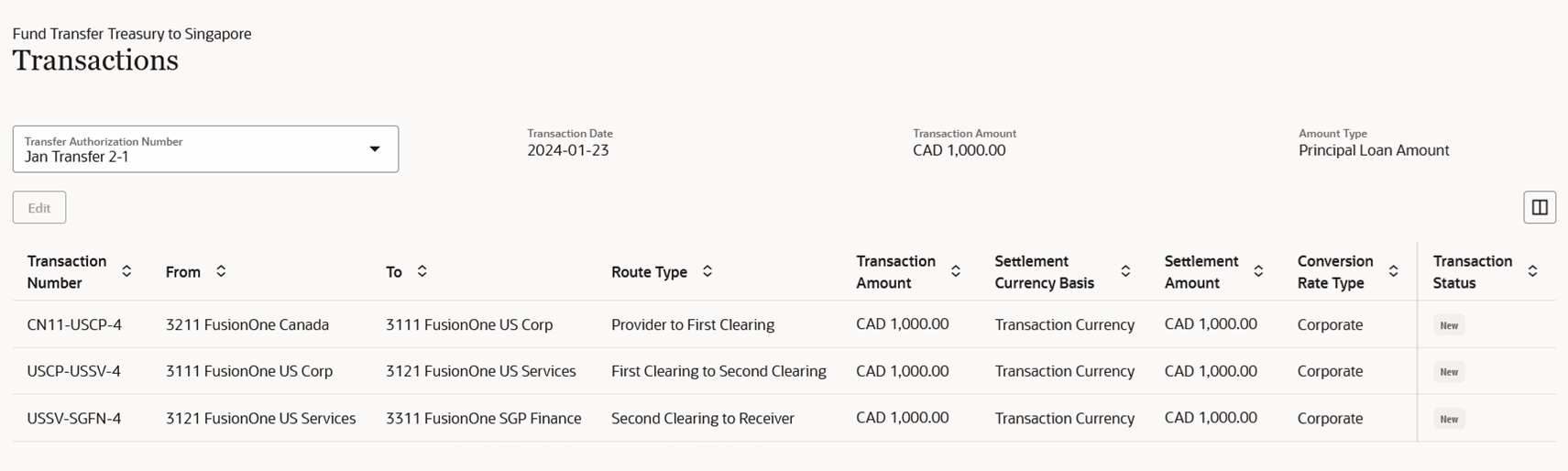

In the below example, three transactions result from the authorization, starting from provider to receiver through two clearing organizations.
Transactions generated by the system based on the financial route

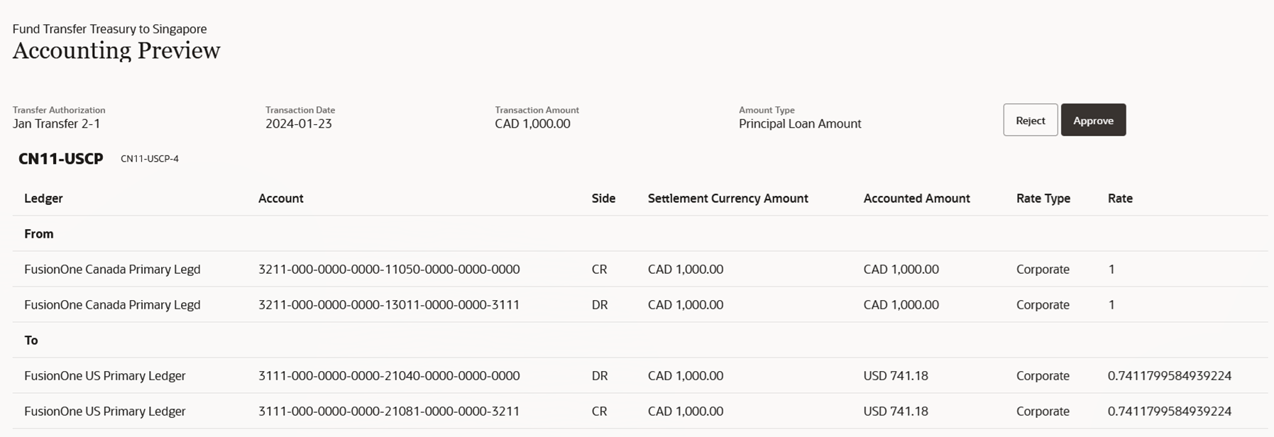

The early preview of the accounting is generated for each transaction.
Preview of Accounting for a Transaction
