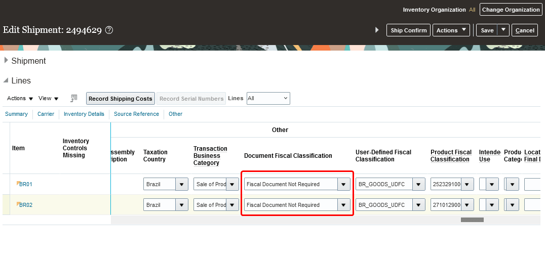

Create Shipping transactions in Brazil without a fiscal document. Enable the configuration option to allow creation of a Shipping transaction without generating a fiscal document. Some Brazilian companies work with third-party solutions to address specific business processes such as exports or e-commerce. Such third-party solutions are able to create the required fiscal documents and they do not require generating fiscal documents using Shipping.
Use a document fiscal classification configured in the Manage Fiscal Document Generation Control page to define if a shipping transaction requires a fiscal document.
NOTE: All shipment lines in a shipment must be marked as either requiring a fiscal document or not requiring a fiscal document. If the shipment lines in a shipment contain a mix of fiscal documents required and not required, you can neither confirm the shipment nor request a fiscal document
Manage Shipment Lines page

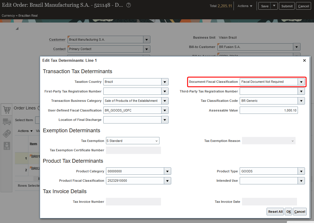

The Document Fiscal Classification field is also available at sales order line as a tax determinant. This information will be copied to the corresponding shipment line if provided.
Create Order page
Create Order page

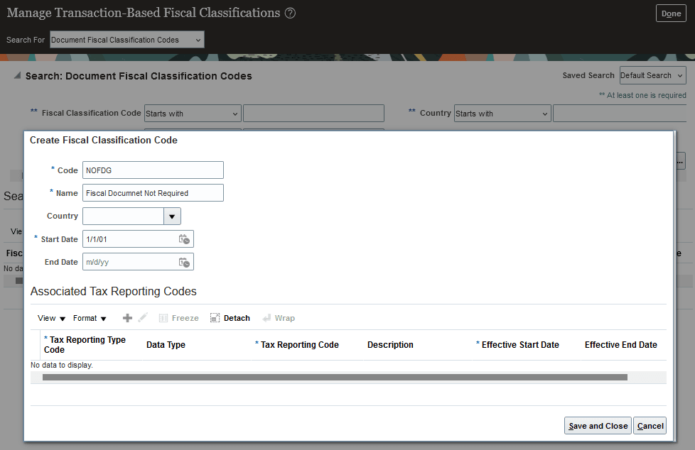

CREATE A DOCUMENT FISCAL CLASSIFICATION
  1. Navigate to the Manage Transaction-Based Fiscal Classifications page.
  2. Search for document fiscal classification codes.
  3. Click Create Level 1 Node.
  4. Enter the code, name, and start date for the fiscal classification code.
  5. Click Save and Close.
  6. Select the level 1 node that you just created and click Create Child Node.
  7. Enter the code, name, and start date for child fiscal classification code.
  8. Click Save and Close.
Manage Transaction-Based Fiscal Classification page
