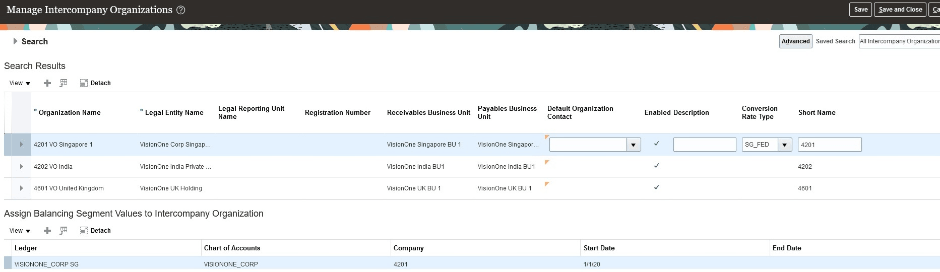

Use the Intercompany Organization set up page to define the organization specific rate type. In the below example, rate type is defined only for Singapore Intercompany organization due to country specific requirements.
Intercompany Organization Set up UI

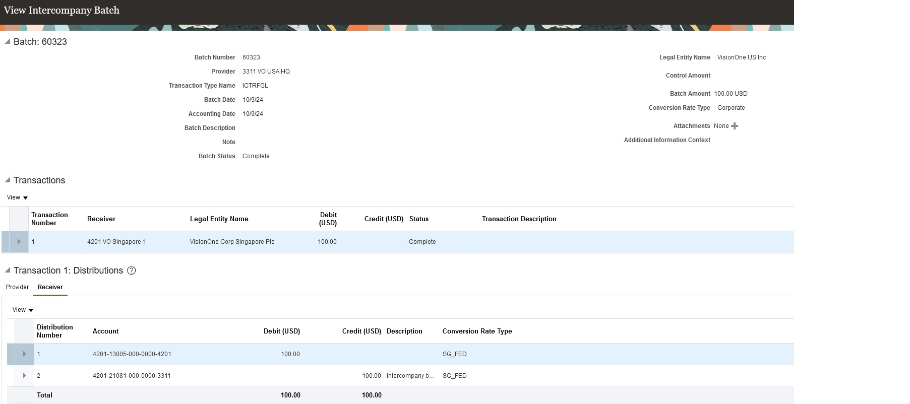

Appropriate rate type thus determined during the transfer process for provider and receiver organization respectively are displayed at the distribution details section of Intercompany Transactions page.Intercompany transaction displaying rate type at the distribution level
