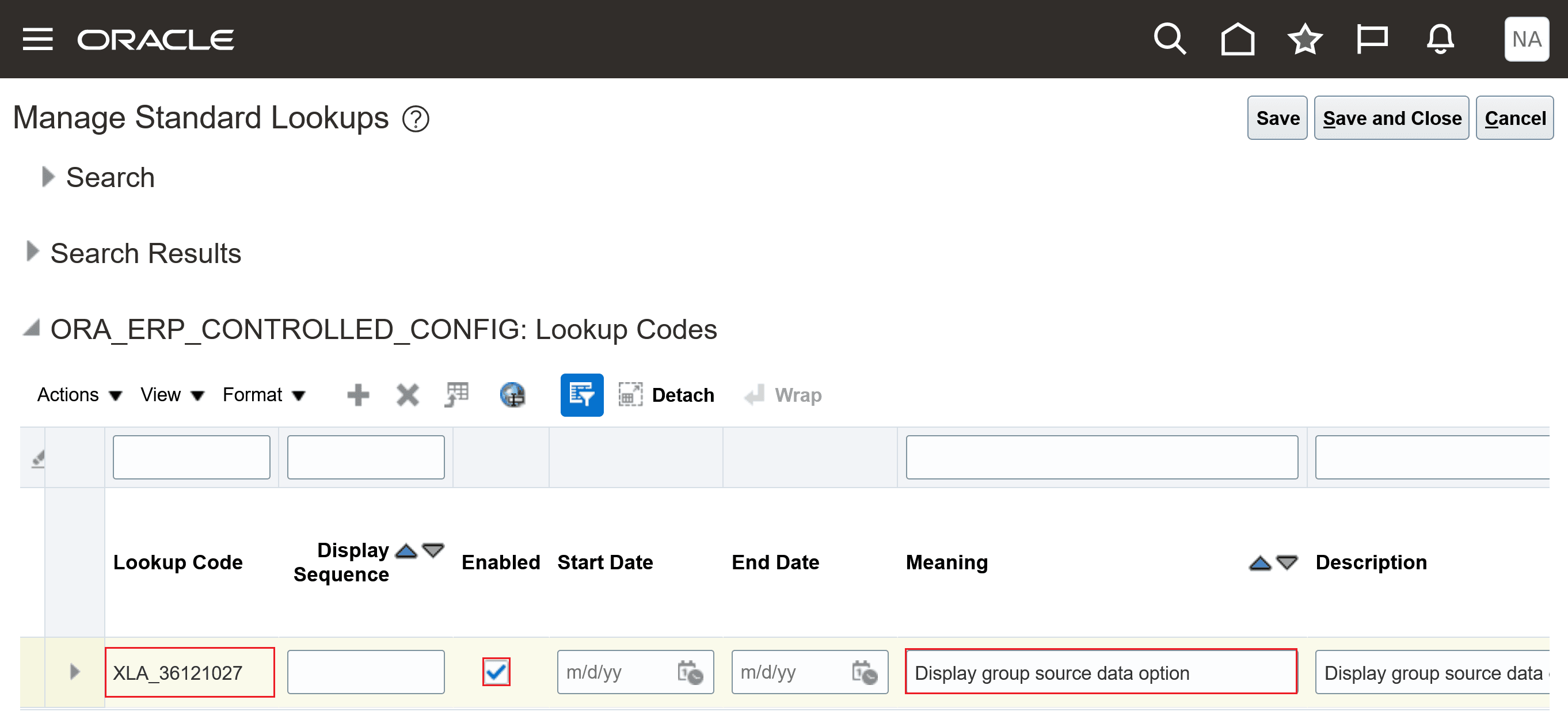

  1. Add a promotional option code to display the group source data option for the event class.
    • Navigate to Setup and Maintenance.
    • Search and navigate to the Setup Task: Manage Standard Lookups.
    • Search for the Lookup Type: ORA_ERP_CONTROLLED_CONFIG.
      • Lookup Code: XLA_36121027
      • Enabled: <Checked>
      • Meaning: Display Group source data option in UI
    • Save the changes.
Add lookup code XLA_36121027

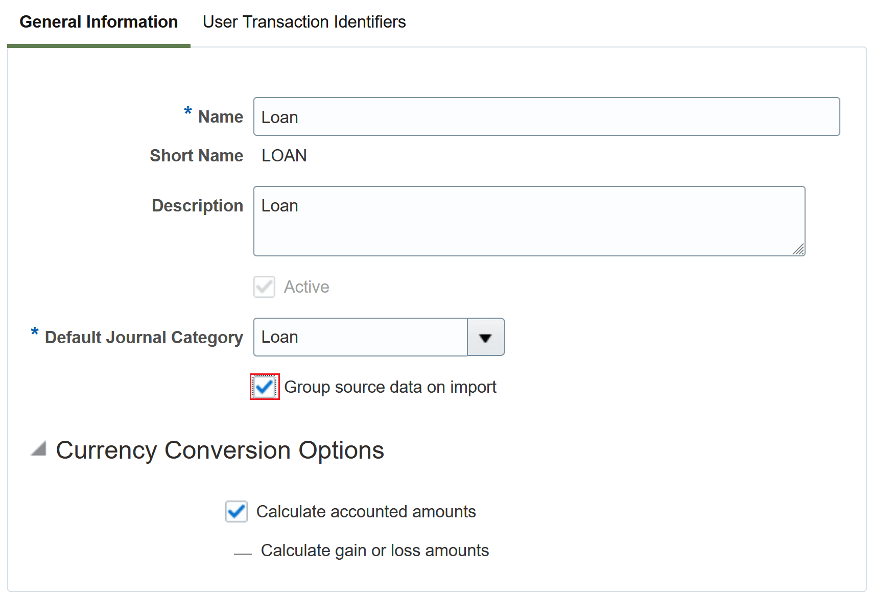

  1. Enable the group source data on import in the Manage Subledger Applications task.
    • Select the Setup Offering: Fusion Accounting Hub.
    • Click on the Functional Area: Accounting Transformation.
    • Click on the Setup Task: Manage Subledger Applications with scope set for your accounting hub subledger.
    • Select event class in the event model hierarchy.
    • Select the 'Group source data on import' option.
    • Save the changes.
Check the Group source data on import option.

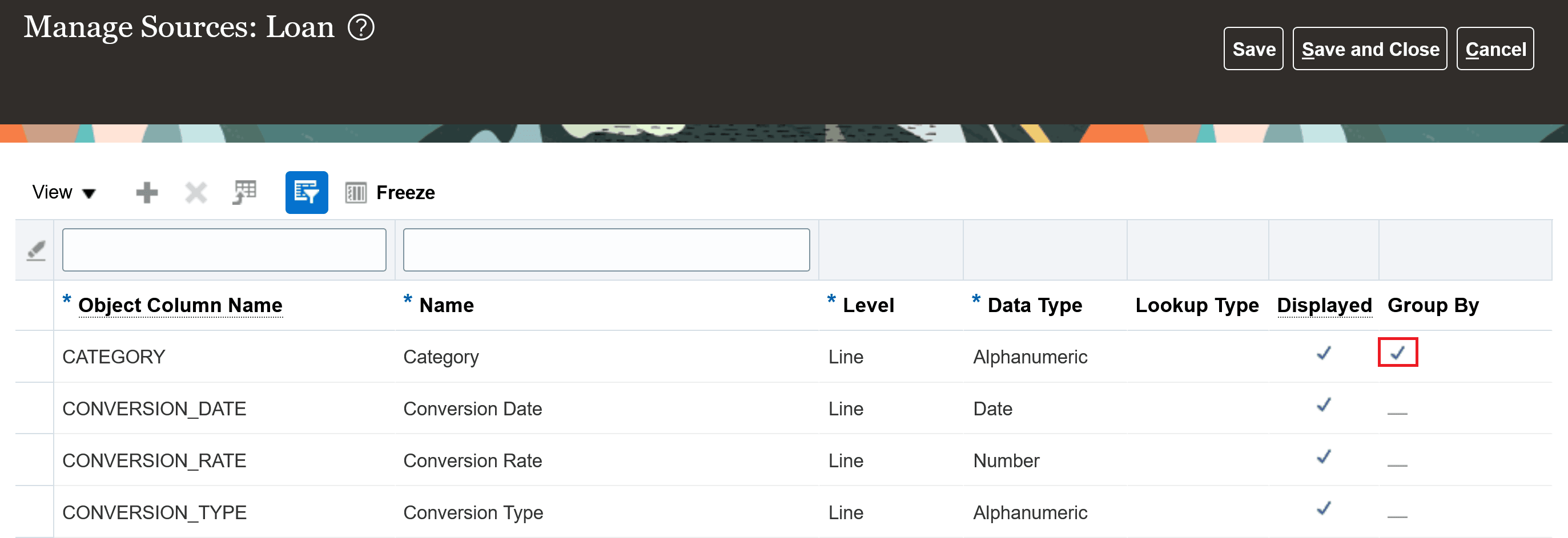

Configuring Additional Sources as Grouping Attributes
Assign additional sources as grouping attributes if applicable. You can assign any line level source as grouping attribute so that transaction line with different value in default currency and grouping attributes won't be grouped into the same event.
  • Click on the Setup Task: Manage Sources with scope set for your accounting hub subledger.
  • Check the 'Group By' attribute for the source.
  • Save the changes.
Assign additional group by sources

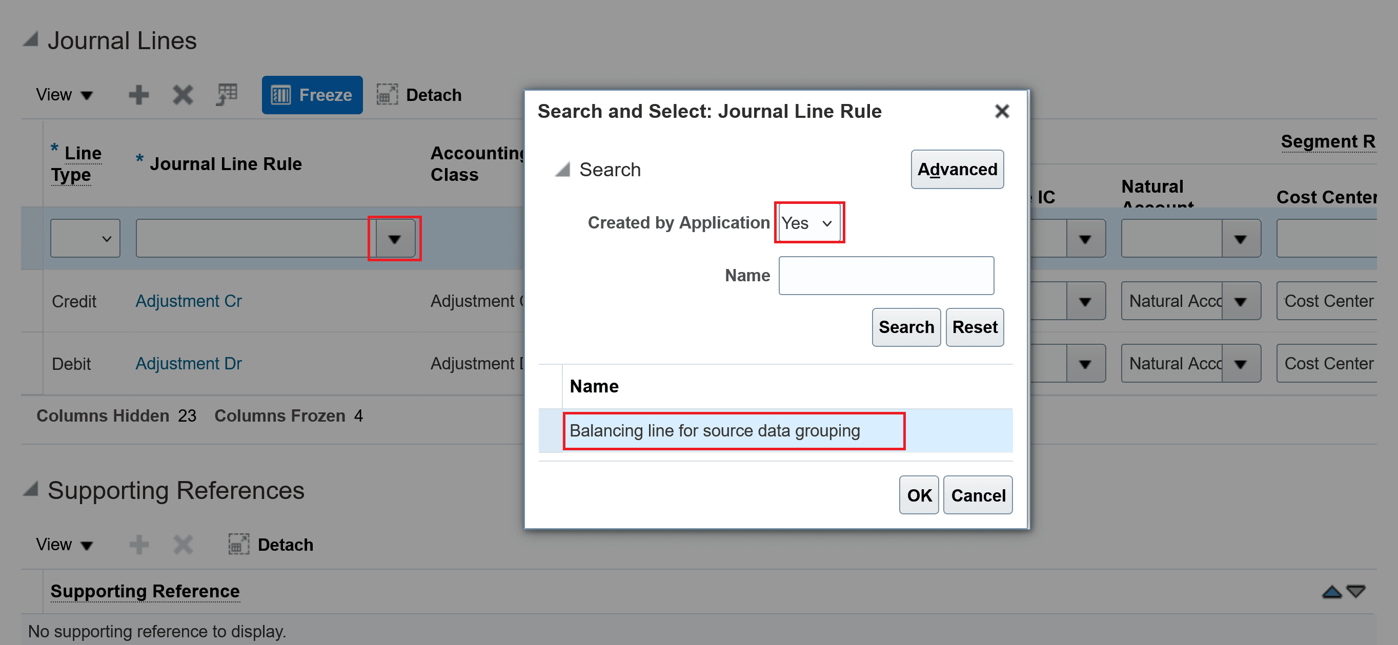

  • Add a row in the journal line region.
  • Search for the pre-defined journal line rule 'Balancing line for source data grouping' and assign to the rule set.

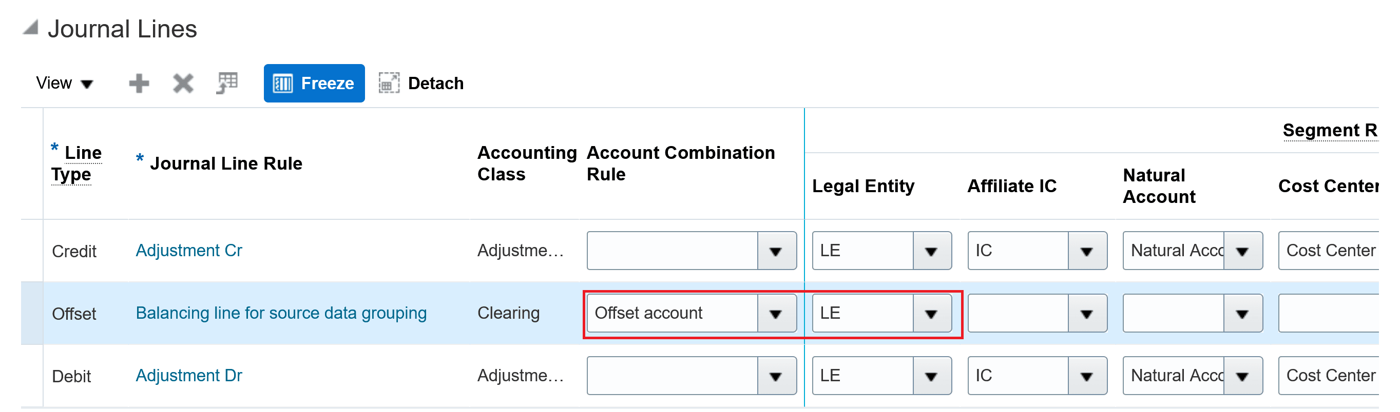

Add Balancing line for source data grouping journal line rule to your rule set.
  • Assign account rule(s) to the 'Balancing line for source data group'.
  • Save the changes.
