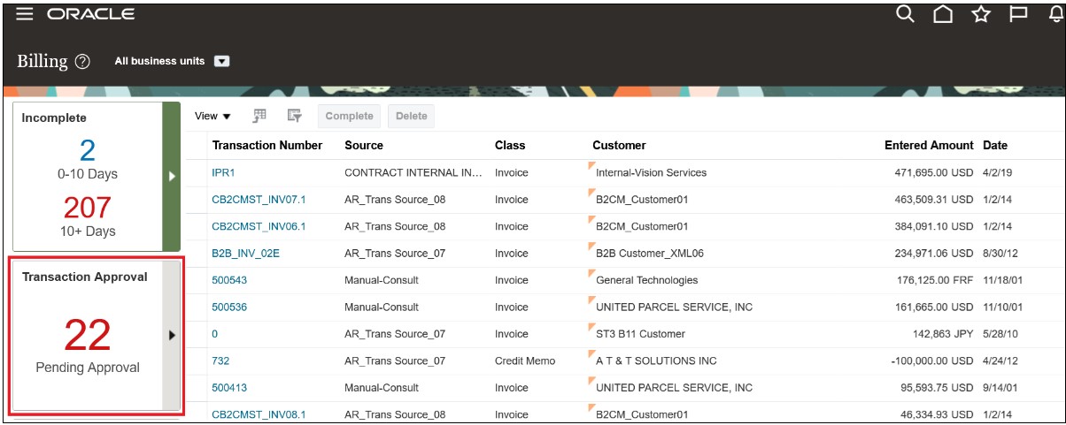

Transaction Approval Info Tile
Transaction Approval Infotile
Approvers use the Transaction Approval info tile to review transactions that are pending their approval.
Depending on the type of control, approvers will see the following transactions:
- User-Based control: Pending Approval transactions available for review to approvers assigned to rules in the SRC spreadsheet template.
- Role-Based control: Pending Approval transactions available for review to approvers with the Approve Receivables Transaction privilege.

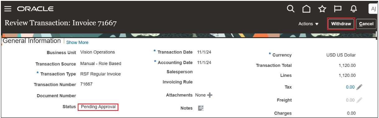

Withdraw Pending Approval Transactions
Withdraw Pending Approval transactions
Use the Withdraw button in the Review Transaction page to withdraw an invoice or credit memo that is pending approval. After making any corrections, the transaction can be resubmitted. The Withdraw button is exposed to the user who manually created the invoice or credit memo, or the user who created invoices and credit memos from a run of the Import AutoInvoice process.

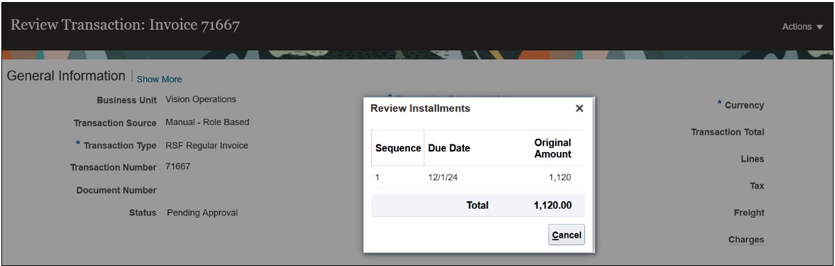

Review Installments window
Use the Review Installments window in the Review Transaction page to view the payment schedules for transactions Pending Approval. The window displays the due date and original amount for each installment, and the total for all installments.

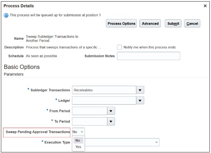

Sweep Pending Approval Transactions
Use the Sweep Subledger Transactions to Another Period process to include a sweep of Pending Approval transactions to a future accounting period.
The process now has an additional option to sweep Pending Approval transactions. You can sweep Pending Approval transactions only if the parameter Sweep Pending Approval Transactions is set to Yes. The default value is No.
You can’t close a Receivables accounting period with invalid transactions or Pending Approval transactions. If you can’t approve all Pending Approval transactions before period close, then include them in the sweep to a future accounting period.
To sweep Receivables Pending Approval transactions to a future accounting period:
- Select Receivables in the Subledger Transactions parameter.
- Select the ledger.
- Select the Close Pending accounting period from which to sweep transactions.
- Select the Open or Future Enterable accounting period to sweep transactions.
- Select Yes in the Sweep Pending Approval Transactions parameter.
- Select the Execution Type. You can review the transactions without sweep or sweep the transactions to the selected accounting period with or without review.
