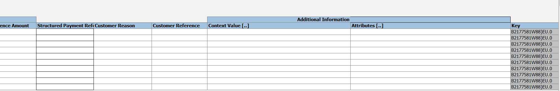

The Create Receipts Using Spreadsheet ADFdi template includes the new columns Context Value and Attributes.

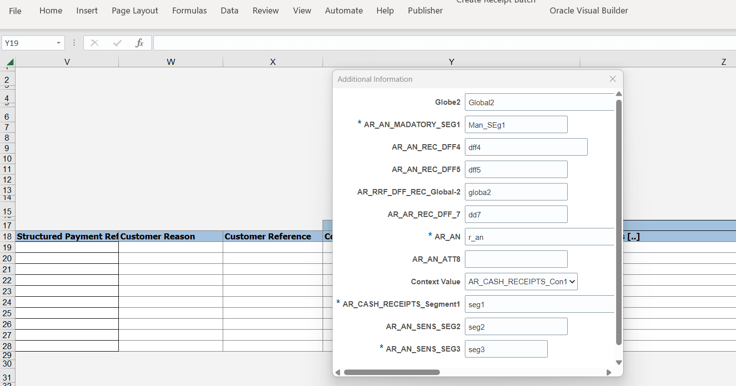

Click a Context Value column cell to open the Additional Information window. The window displays the segments of the AR_INTERIM_CASH_RECEIPTS descriptive flexfield. Enter the values you want in each descriptive flexfield segment and click OK.
Additional Information popup
The Context Value and Attributes columns and Additional Information window help simplify and expedite the process of creating receipts with descriptive flexfield values, when this is a business requirement.
