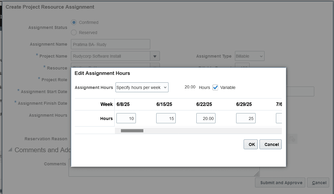

Define detailed weekly schedules when directly assigning a labor resource to a project. Resource managers set precise weekly allocations without the need for a formal resource request and allocate team members based on real-time project demands. Adjust multiple resource assignment schedule hours or switch between variable weekly hours and other scheduling methods to reflect the latest schedule demands. Replace resources on variable weekly hour assignments to address availability and workload balance.
Create Assignments for Variable Weekly Hours

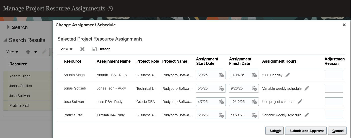

Adjust Multiple Assignments

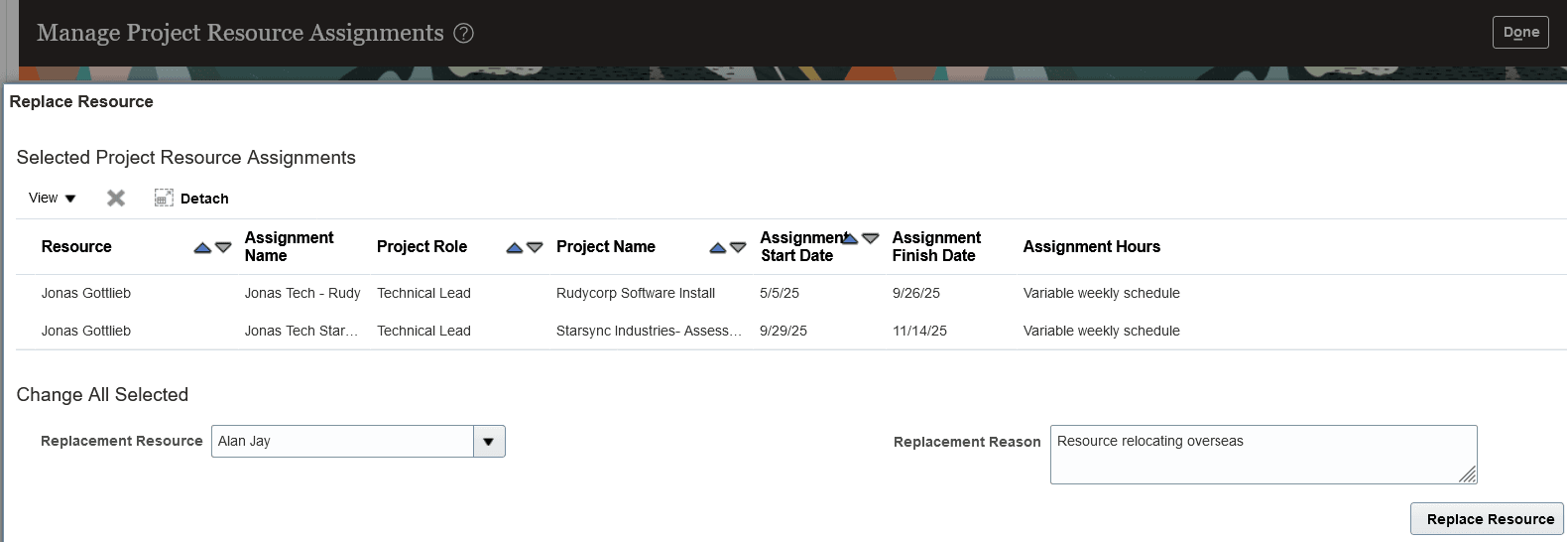

Replace Resources Scheduled with Variable Weekly Hours

- Faster Response to Availability Changes – Quickly replacing resources avoids disruptions and keeps projects on track.

- When adjusting an assignment with variable weekly hours, the assignment hours will shift based on the changes that are made to the assignment start and finish dates and duration:
Start Date |
Finish Date | Duration | Assignment Hours Change |
Earlier |
Earlier | Same |
Shift the existing weekly hours based on the new start date. |
| Later | Later | Same |
| Earlier | No change | Longer |
Shift the existing weekly hours earlier based on the new start date. For additional weeks in the longer duration, set the weekly hours equal to the default weekly hours value. |
| Later | No change | Shorter |
Remove hours for dates no longer part of the assignment. Keep existing weekly hours that were set on remaining weeks of assignment. |
| No change | Earlier | Shorter |
Remove hours for dates no longer part of the assignment. Keep existing daily hours that were set on remaining dates of assignment. |
| No change | Later | Longer |
| Earlier | Later | Longer |
Shift existing hours to start at new start date, add the default weekly hours for each additional week to the end of the assignment for additional weeks added to the duration. |
| Later | Earlier | Shorter |
Shift existing hours starting at the new start date. Remove hours at the end for weeks no longer within the new duration. |
| Later | Later | Shorter | Shift existing hours starting at the new start date. Remove hours at the end for weeks no longer within the new duration. |
