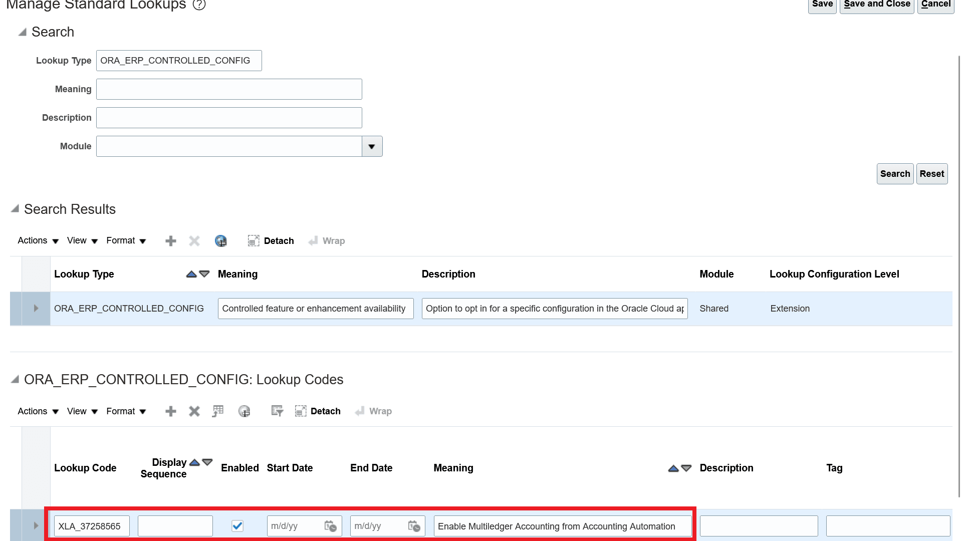

  1. Navigate to Setup and Maintenance.
  2. Search and navigate to Task: Manage Standard Lookups.
  3. Search for Lookup Type: ORA_ERP_CONTROLLED_CONFIG.
  4. Define a lookup code under the above lookup type with the following details -
    • Lookup Code: XLA_37258565
    • Enabled: <Checked>
    • Meaning: Enable Multiledger Accounting from Accounting Automation
  5. Save the changes.
