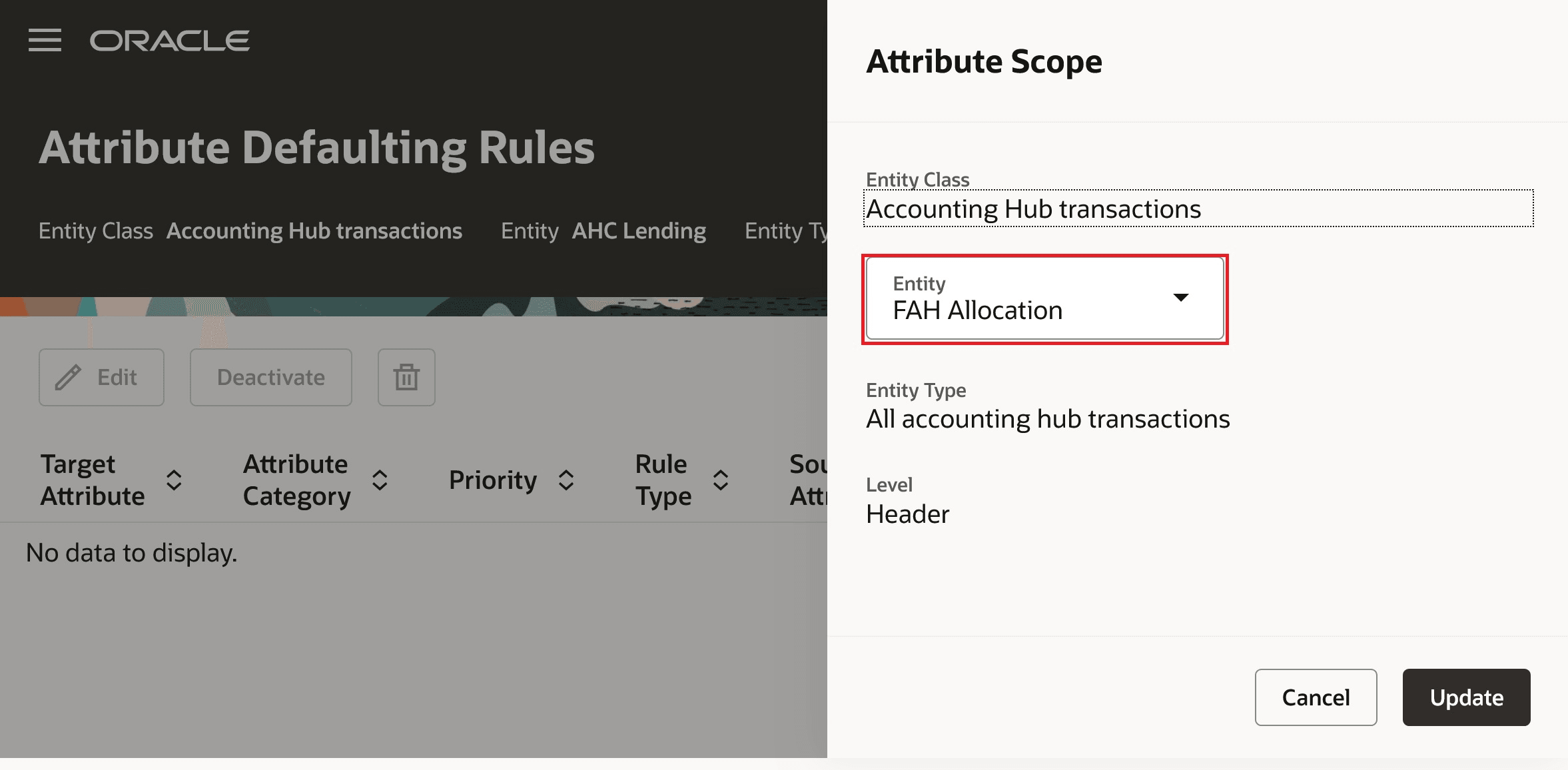

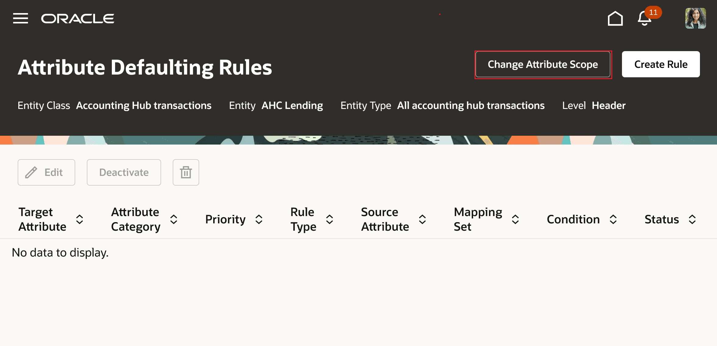

  2. On the Attribute Defaulting Rules page, change the attribute scope and select the subledger application in the Entity field. Change scope
    Change scope
    Select scope
    Select scope

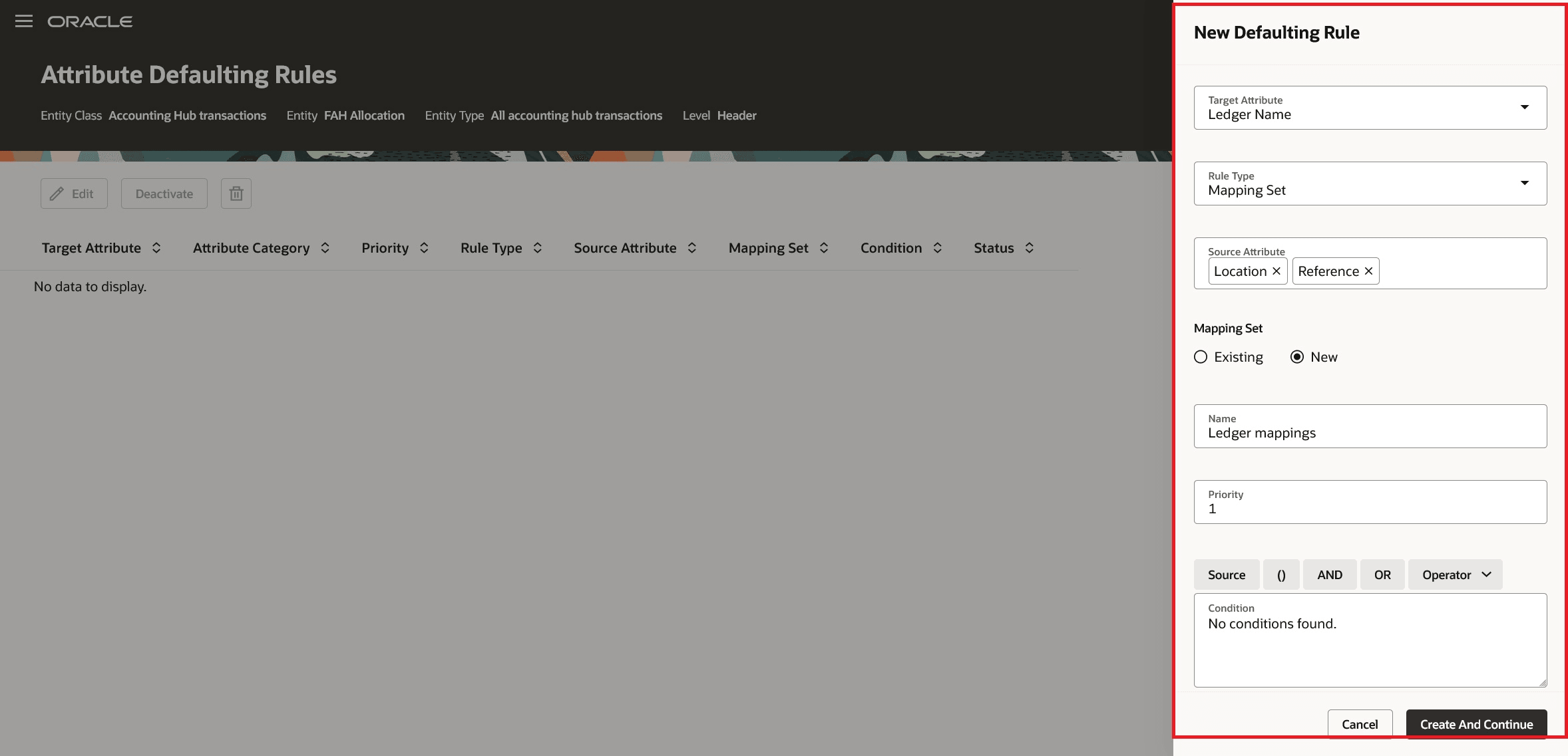

  3. Create a new defaulting rule by selecting target attribute Ledger Name, source attributes Location and Reference, and rule type Mapping Set.Create new rule with mapping set as rule type.

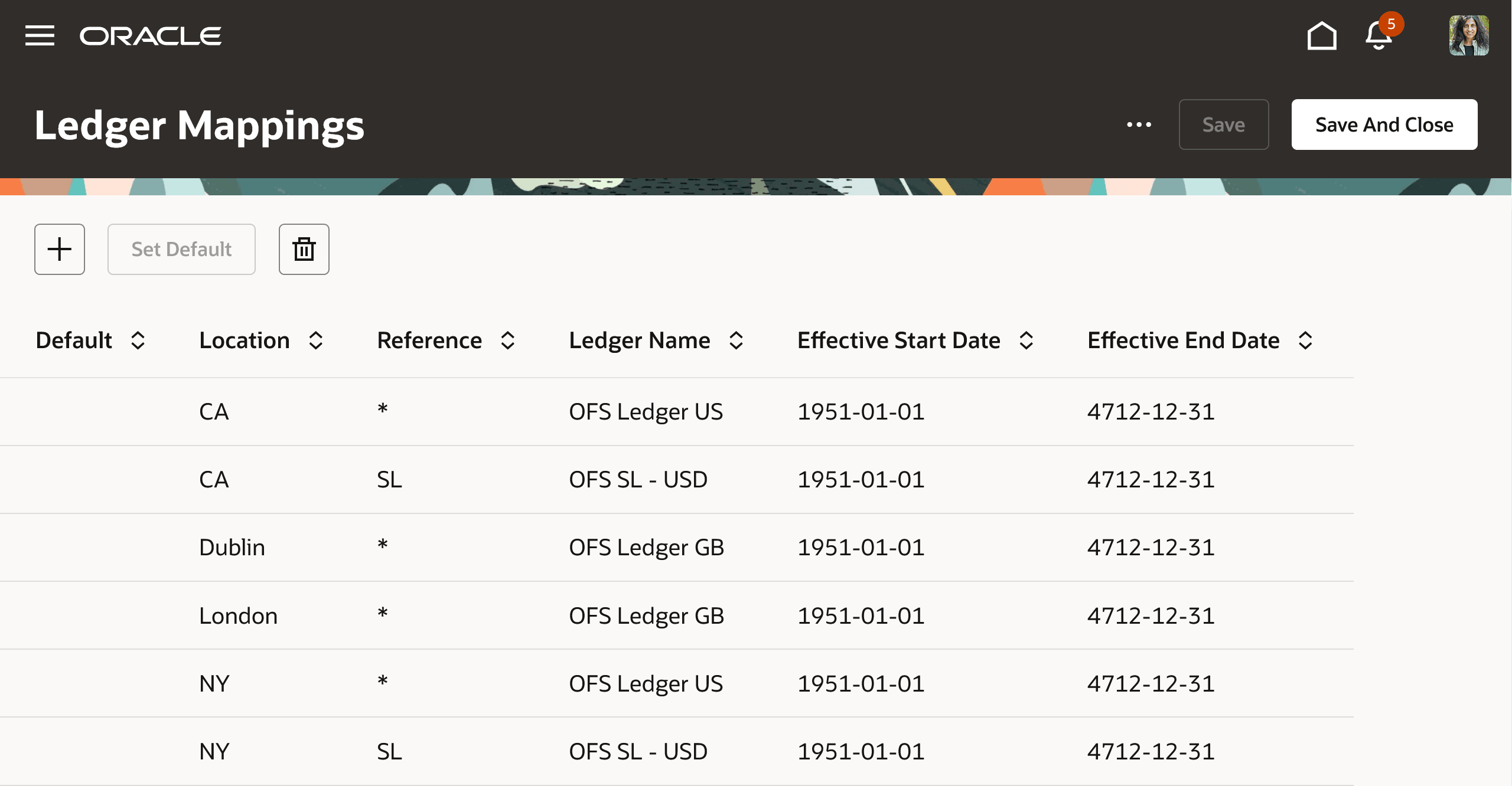

  4. Enter a valid ledger for each combination of Location and Reference. Use an asterisk(*) to indicate 'any value' for cases with no explicit mappings defined.
In the below example, if Location is CA and Reference is SL for a transaction, the ledger will be OFS SL – USD.  If Location is CA and Reference is not SL, the ledger will be OFS Ledger US. If Location is Dublin, the ledger will be OFS Ledger GB, regardless of the Reference value.
Attribute Mapping Set

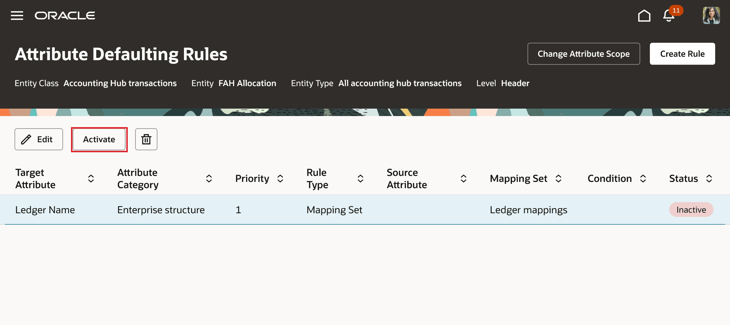

  1. Save the mappings and activate the rule in the Attribute Defaulting Rule page before it can be applied during the Import Accounting Transactions process.Activate attribute defaulting rule
