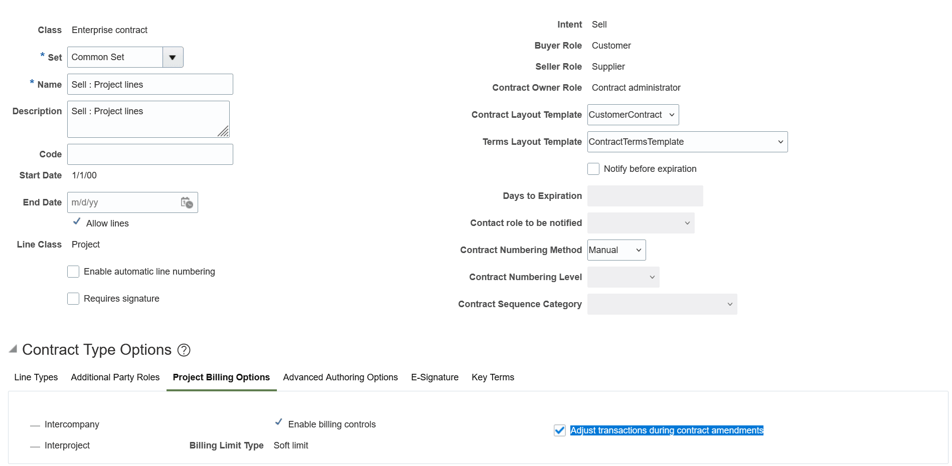

The application implementation consultant can enable or disable the Adjust transactions during contract amendments option in the Project Billing tab of the contract type setup, as highlighted below.
Adjust Transactions During Contract Amendments Option
Contract Type Setup

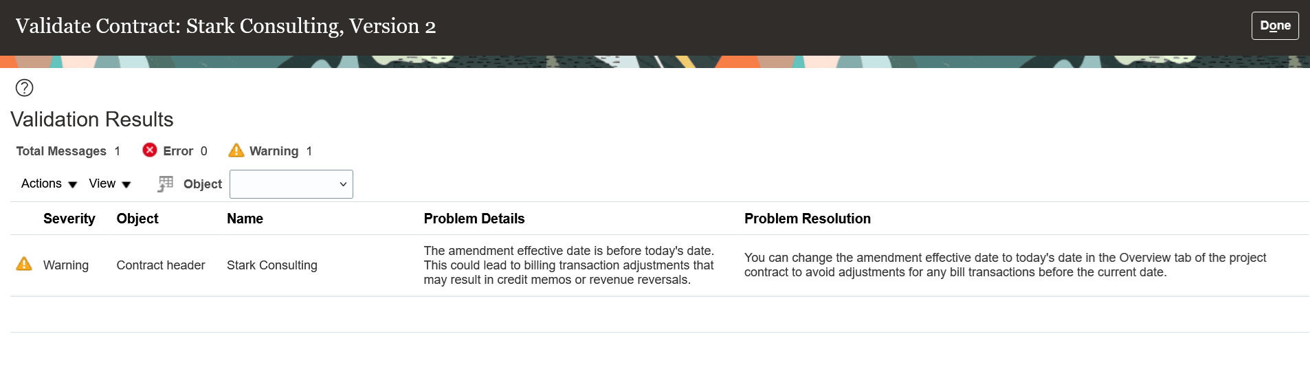

  • The warning message shown below is not displayed during project contract validation when a retroactive amendment effective date is provided under either of the following conditions:
    • The Adjust transactions during contract amendments option is disabled at the contract type setup level
    • The project contract is amended without versioning, regardless of the value of the Adjust transactions during contract amendments option in the contract type setup.
Contract Validation Warning Message
