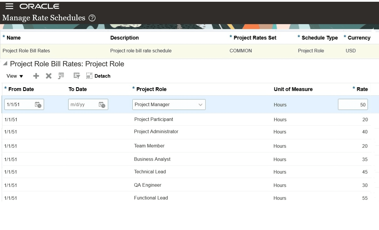

A professional services organization bills their clients on a time and expenses basis, where time is priced by project role. For example, the Business Analyst role may be billed at $35/hour, but the Project Manager role may be billed at $50/hour.
Project role rate schedules are created, capturing standard project role rates for all billable project roles. Multiple schedules can be created if there is variation by line of business, client, location. The following screenshot shows an example of a project role rate schedule:
Project Role Rate Schedule

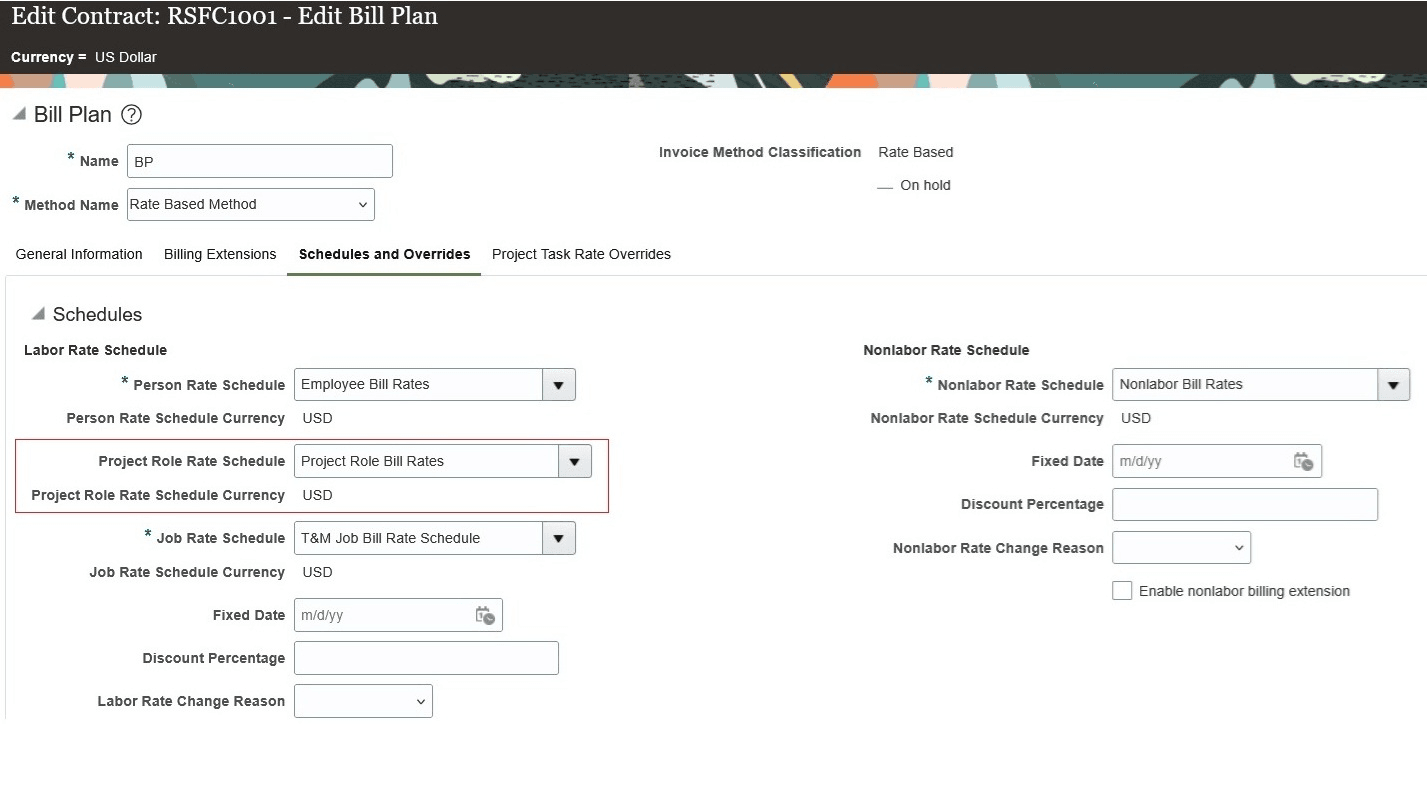

Project role rate schedules are then assigned to bill plans as appropriate, with the option of using bill plan overrides to handle exceptions. The following screenshot shows the bill plan page, with the new Project Role Rate Schedule and Project Role Rate Schedule Currency fields:
Project Role Rate Schedule on Contract Bill Plan
With the above setup done, all bill transactions with project role on it, will be billed by the rates defined in the project rate schedule. Person rate schedule does take higher precedence than Project Role rate schedule. If only project role rates should be used, define Person and Job rate schedule with no rate lines. These rate schedules can be assigned to Person and Job rate schedule on the bill plan, as these are mandatory attributes on the bill plan.

  • Unlike Job, Person, and Nonlabor rate schedules, project role rate schedules are not mandatory, meaning they only need to be assigned to bill plans if needed.
  • Project role rate schedules have a higher precedence than a job rate schedule if both are assigned to a bill plan. For example, consider a labor transaction being recorded for a person with the job "Consultant L2" and the project role "Project Manager". If the corresponding bill plan has both job and project role rate schedules assigned, containing "Consultant L2" and "Project Manager" respectively, the bill rate for the Project Manager project role will be used.
  • If only project role rates should be used, define Person and Job rate schedule with no rate lines. These rate schedules can be assigned to Person and Job rate schedule on the bill plan, as these are mandatory attributes on the bill plan.
  • Project/Task overrides on the contract bill plan still holds the highest precedence. Rates defined in Project/Task overrides will have higher precedence than rates defined in any rate schedules assigned to the bill plan.
