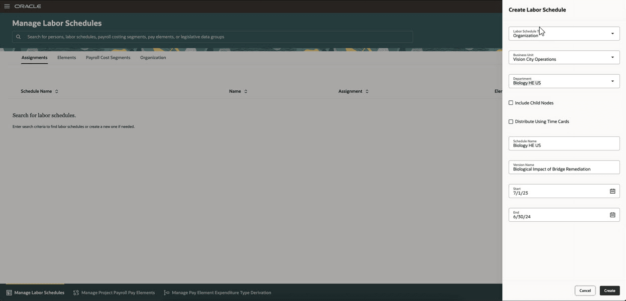

As illustrated below, this Organization labor schedule type will only match to payroll costs for the department of Biology HE US and will not match to any child node departments within the associated organization tree.
Organization Labor Schedule Image
