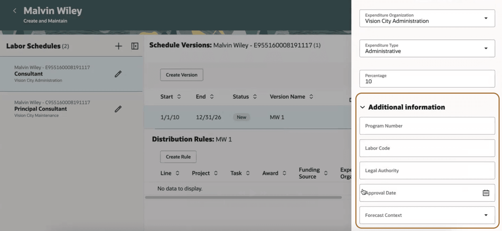

  • Descriptive Flexfields for Project Labor Schedule Distribution Rules: Gain granular control over your labor schedule data with Descriptive Flexfields (DFF). Enable and manage additional attributes tailored to your specific needs, directly within the management of labor schedules.
    • You can manage the descriptive flexfield values when creating and maintaining distribution rules using REST operations, the file-based data interface (FBDI), and in the Manage Labor Schedules page in the "Additional Information" area illustrated below.
Create Distribution Rule Descriptive Flexfield Attributes

Steps to enable and configure
To deploy the descriptive flexfield for your labor schedule distribution rules:
  1. Log in as a user who has access to Setup and Maintenance work area.
  1. Navigate to Setup and Maintenance > Manage Descriptive Flexfields.
  1. Search for the program's flexfield using the following details:
  • Name: Labor Distribution Rules Descriptive Flexfield
  • Flexfield Code: PJC_LD_SCH_TARGET_LINES_DFF
  • Module: Setup
  • Click Search.
  1. Click the Edit icon to make any necessary changes to the flexfield based on your business needs. Refer to the Overview of Descriptive Flexfields topic in the Configuring and Extending Applications guide for detailed instructions on how you can manage flexfields.
  1. Click Save & Close to finalize your changes. Then, click Deploy Flexfield to make the updated flexfield visible in both the user interface and the REST service.
