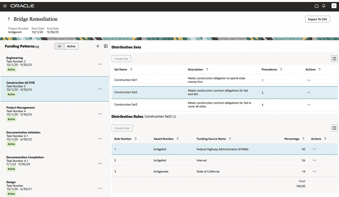

Distribute expenses for sponsored projects automatically based on the designated funding patterns. At the time of expense entry, the employee only needs to specify the correct project, task, and expenditure organization. The expenses are allocated to awards and funding sources based on the defined funding pattern. This helps ensure accurate distribution of project costs for sponsored project expenses that have multiple funding sources and reduces manual corrections during the expense entry and reimbursement process.
Grant Administrators create and maintain funding patterns once a project receives funding from one or more awards and associated funding sources.
Sponsored project expenses are now automatically distributed according to assigned funding patterns. By specifying an expenditure item date range and task level, customers can apply distribution rules that automatically split sponsored project costs, eliminating the need for manual entry of award charging instructions.

Defining Funding Patterns

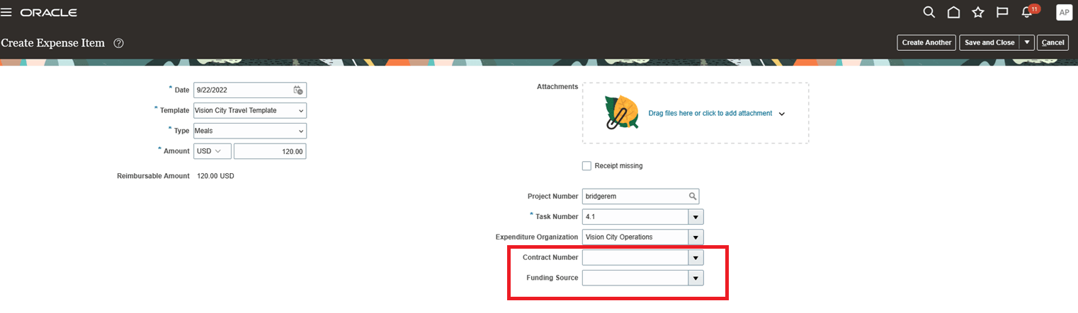

Employees no longer need to worry about contract and funding source details or how the expense cost is distributed. They simply need to provide the project, task, and expenditure Organization information, and the system will handle the rest based on the active funding pattern. Manual entry of contract number and funding source details is only required if the sponsored project does not have predefined funding patterns.
Expense submission with only Project and Task Details

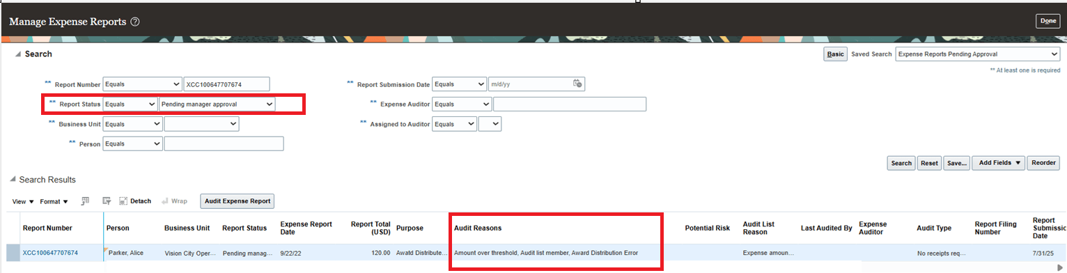

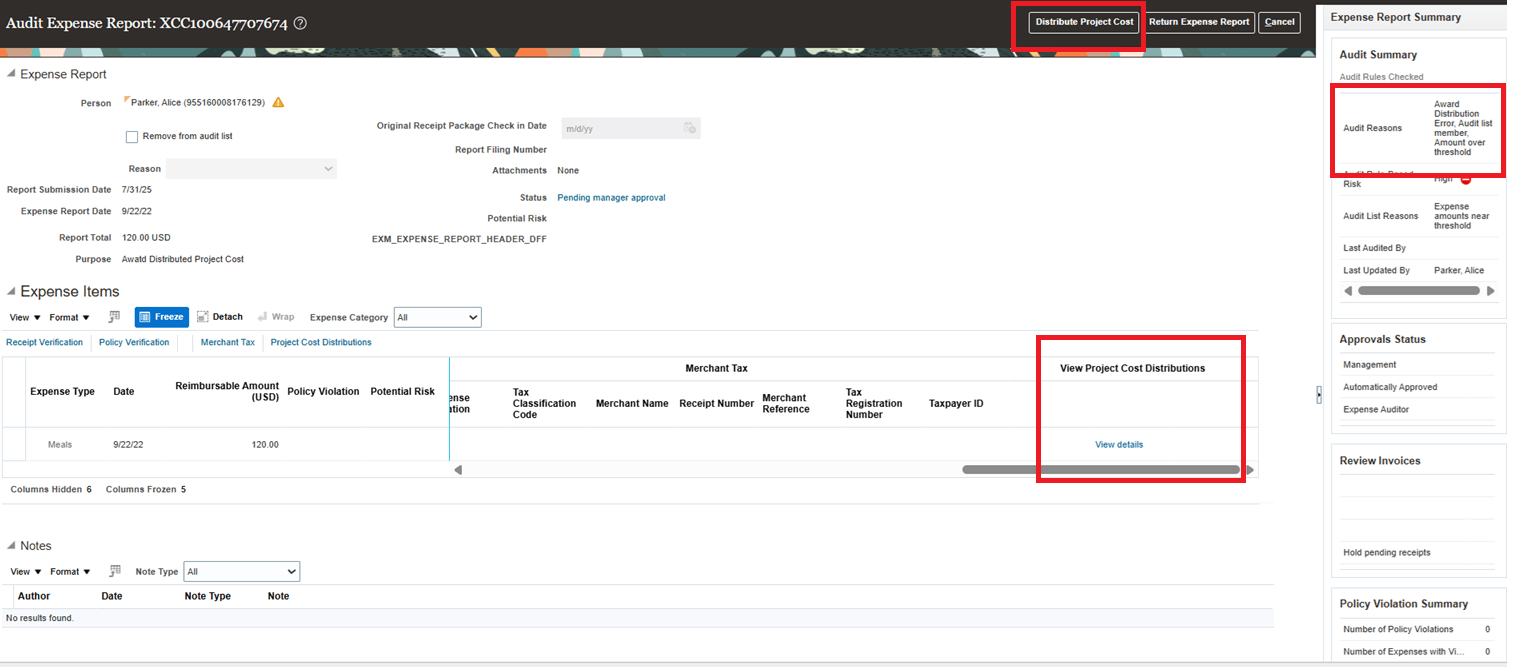

If the process is unable to distribute the costs, the expense report remains in the “Pending manager approval” status and is not routed to the manager for approval. The distribution related information, including errors, will not be displayed to employees. Only Auditors, Grant Accountants, or Administrators with appropriate privileges can view the failed distributions using the Project Cost Distribution Results page. The system displays the cause of each error, allowing users to take corrective action such as adjusting the funding pattern. Once resolved, distributions can be regenerated using the expenses audit page.
The Project Cost Distribution Results page will display the funding patterns, distribution sets, and rules that were used for the failed transaction.
Users with privileges to access the Audit work area and generate cost distributions can search for reports that are pending manager approval due to failures in the cost distribution process. They can open the report and view details in the View Project Cost Distribution Details section. This opens the Project Cost Distribution Results page where errors can be reviewed. After resolving the issues, the user authorized to view and correct the distribution can regenerate the distributions by clicking Distribute Project Cost again. The employee is not impacted by any failures or corrections during this entire process. The report automatically resumes the approval flow, once award-related distribution errors are corrected.
Audit Search Page
Audit Search Page
Expense with Failed Project Cost Distribution
