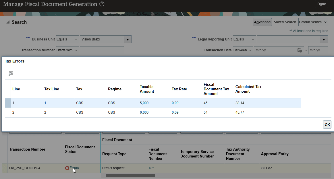

The tax authority integration partner can offer a solution to validate the fiscal document taxes calculated by Cloud ERP using a tax calculation engine provided by the tax authority before sending the fiscal document for approval. If there is any discrepancy in the tax amount, the tax authority integration partner can return such calculated taxes and mark the fiscal document transaction with tax error using the Import Fiscal Document Approval Information FBDI.
You can compare the taxes calculated by the tax authority calculation engine with the Cloud ERP taxes in the Manage Fiscal Document Generation page and reprocess the transaction after the cause is corrected. If the recalculated taxes don't match the taxes calculated by the tax authority calculation engine, the fiscal document status will remain in Error status.
Manage Fiscal Document Generation page, displaying the tax differences
