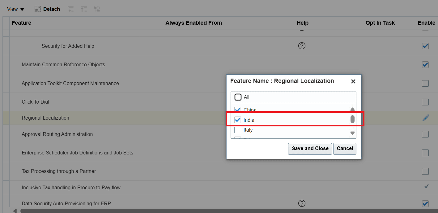

Enable India in Regional Localizations.

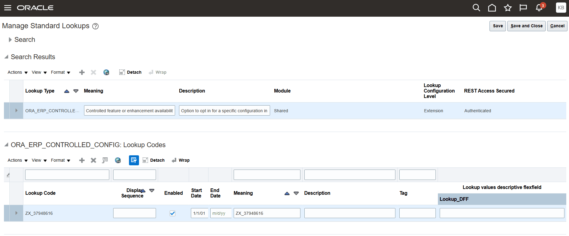

Create and enable a new lookup code ZX_37948616 for the existing ORA_ERP_CONTROLLED_CONFIG lookup type using the Manage Standard Lookups FSM task.
Lookup Details
Lookup Details

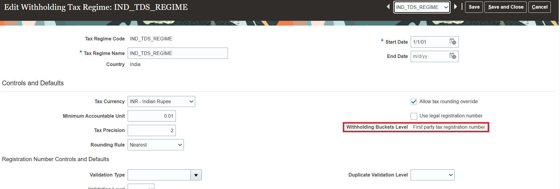

The withholding tax regime defined for India must have the Withholding Buckets Level set to First party tax registration number.
Withholding Tax Regime Buckets Level

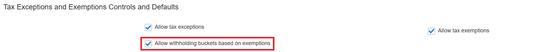

Enable the Allow withholding buckets based on exemptions option for the tax.
Tax Setup
Tax Setup

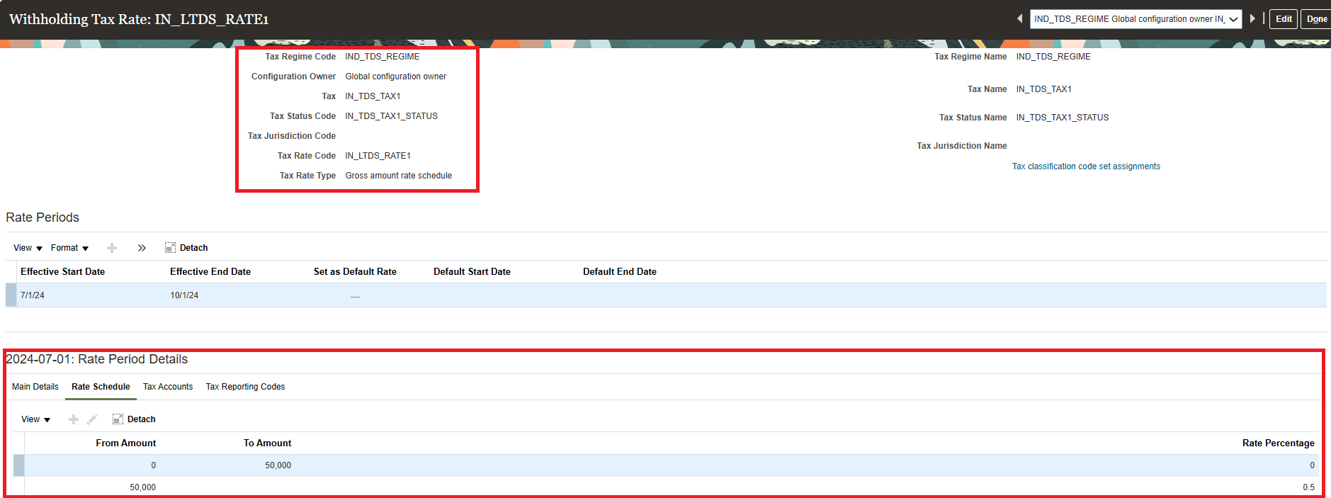

Define a new withholding tax rate for the lower rate.
New Tax Rate for Lower Rate

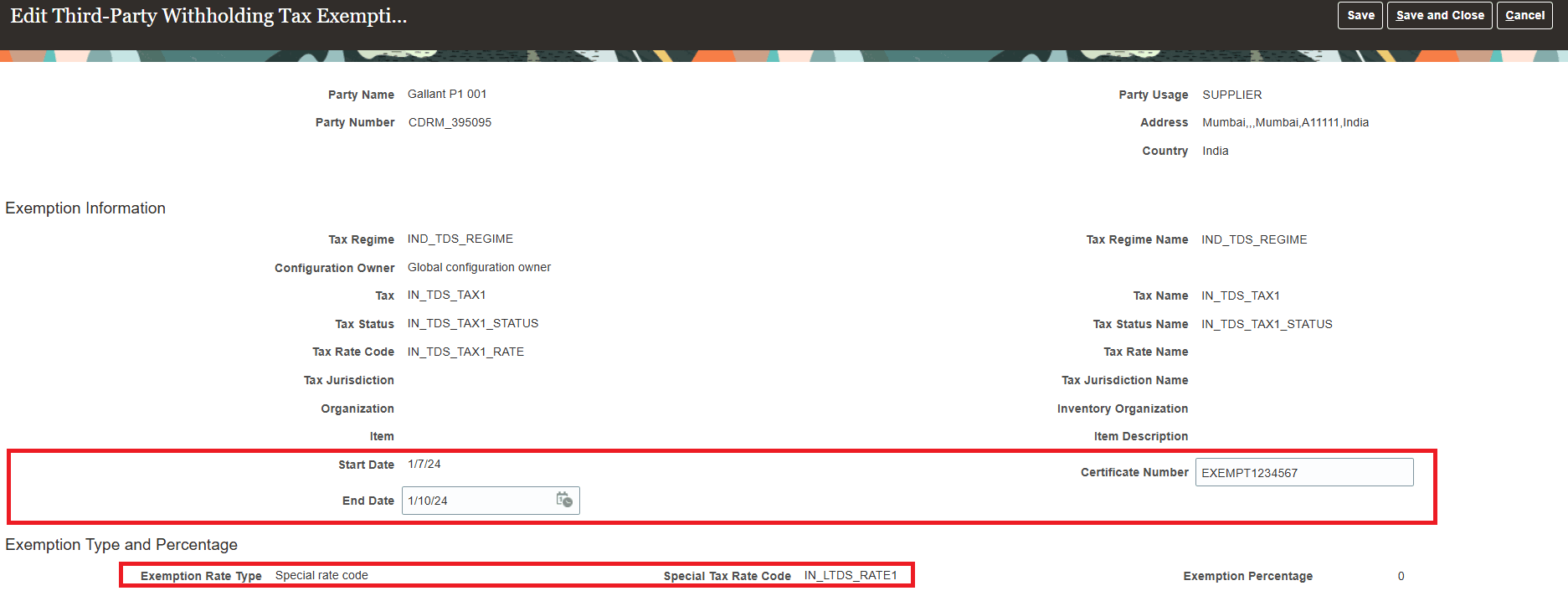

Define a new tax exemption to record the certificate details. Enter the Start Date and End Date based on the certificate's validity period, and enter the Certificate Number. Choose Exemption Rate Type as Special rate code and select the new tax rate defined for the lower rate in the prior step.
Tax Exemption
Tax Exemption
